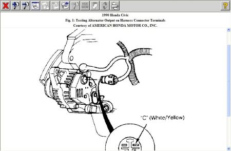

how to adjust fan belt to stop its noise

Hi moj_player, At the upper alternator bracket you would notice a bolt with a slot on the bracket. Unloosen the bolt slightly to enable movement. Use a pry bar or large screw driver to pry the alternator away from engine to increase the tension and retighten the bolt.
