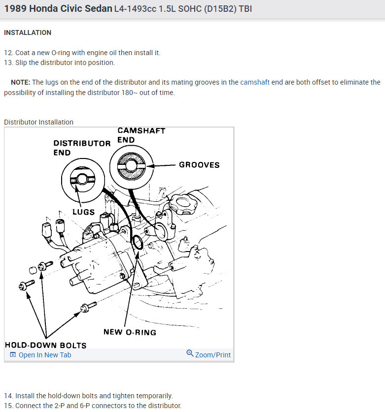

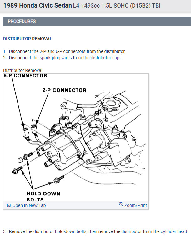

how do i I remove the distributor for replacement?

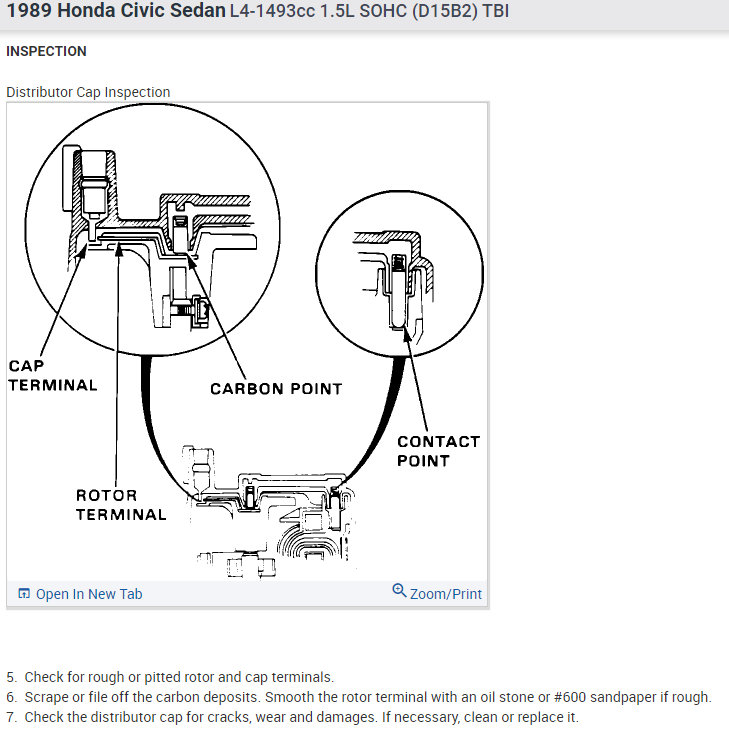

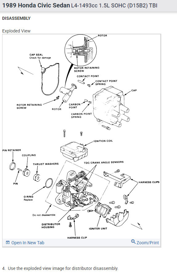

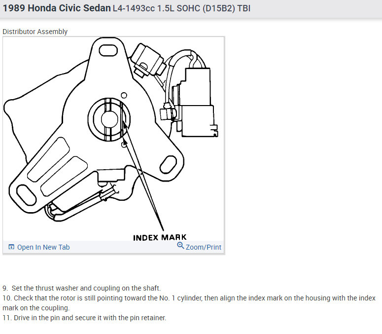

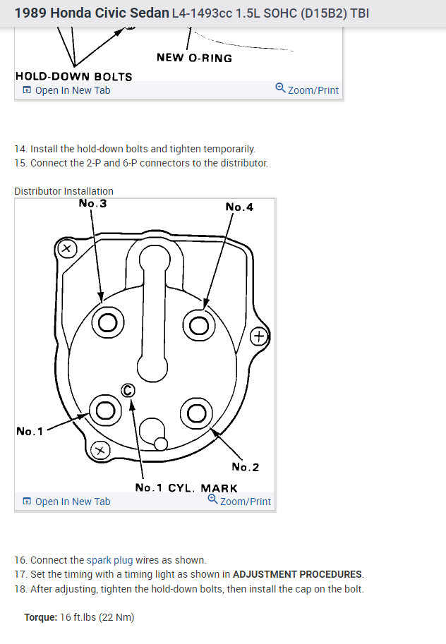

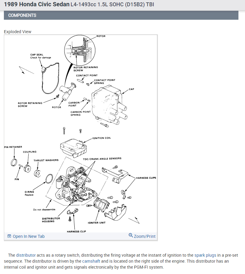

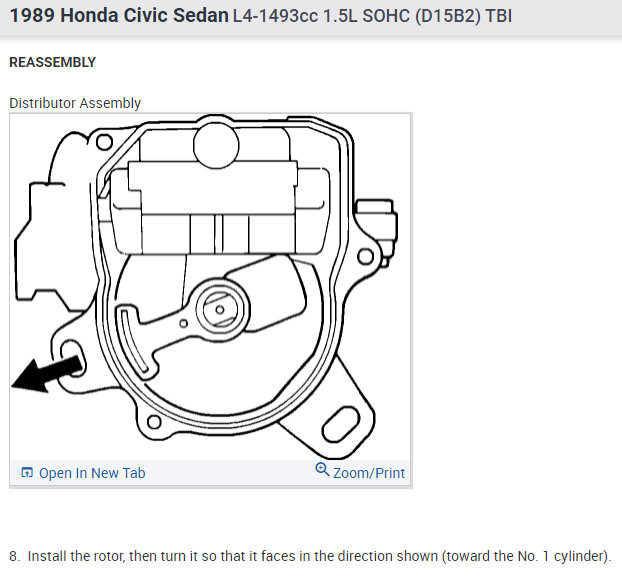

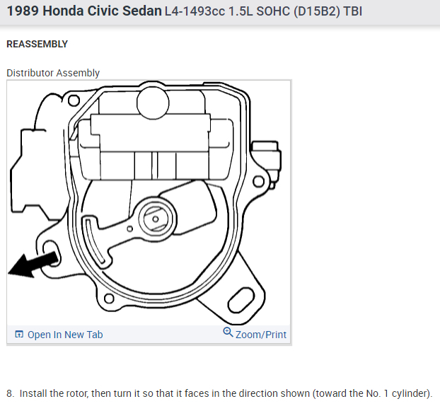

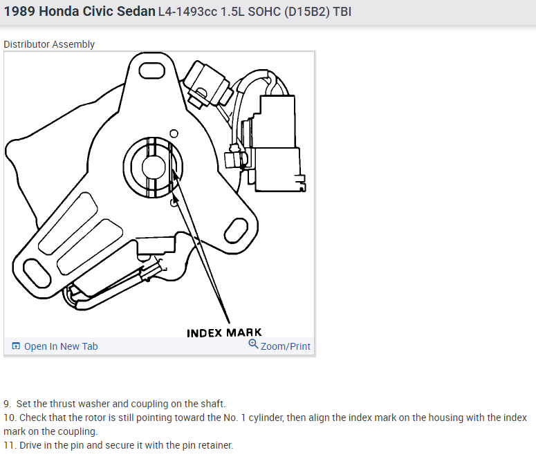

Replacing the distributor can be done using simple hand tools and in a relatively short period of time.
Before getting starter be sure to remove the negative battery cable.
I have attached the replacement procedure for your reference.
