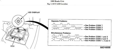

My check engine light turns on after being on 5 minutes and it over heats what can I do to fix it and why does it do that

Hi rostummewlud,
ECU is located under passenger footrest carpet. Pull down the carpet and count the blinking of the LED to get the trouble code for the CEL.
Let me know the code.
