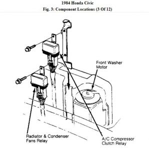

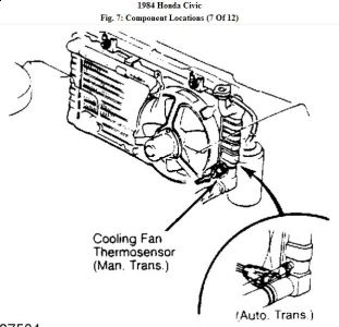

If the fan works with direct voltage applied, the motor is ok so you need to check if it is the fan relay or switch.
Check the thermosensor switch wire for proper connection. If connections are ok, disconnect and bridge them with a jumper wire. Turn ignition switch ON and if fan works, there is no problem with the relay or power supply. The fan switch would be suspect.
https://www.2carpros.com/forum/automotive_pictures/192750_ThermoSensorSwitch84Civic_1.jpg
https://www.2carpros.com/forum/automotive_pictures/192750_FanRelay84Civic_1.jpg
In the fuse box there would be some relays. No relays should be working with the ignition switch OFF, unless you have any alarm system installed. To check which relay is clicking, unplg a relay at a time and while reinstalling, if the realay clicks, note its position and let me know.
