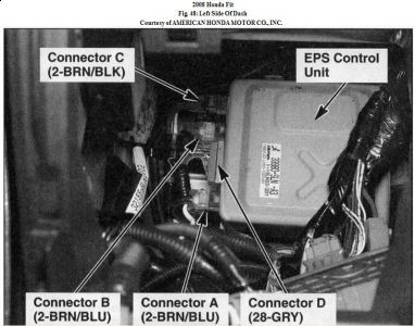

i would like to know where the relay is located for the power steering for a honda city

Hi redyugiohhome,
I only have the data for Honda Fit which is the equivalent of the City.
There are no relays but an EPS control unit located under dash on driver side.
