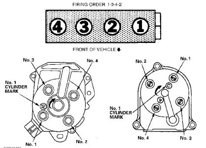

PLUG WIRE LAYOUT
MATTDENNIS
I NEED THE PLUG WIRE LAYOUT FOR A 97 HONDA ACCORD 4-CYL NON-V-TECH ENGINE.I REPLACED THE WIRES AND THE ENGINE IS RUNNING ROUGH,I THINK I INSTALLED THEM INCORRECTLY.I NEED PICS OR A DIAGRAM OF THE PROPER WAY TO INSTALL THEM.THANKYOU.

Check out the images (below). Let us know if you need anything else.
https://images.2carpros.com/forum/automotive_pictures/30961_fior_1.jpg
