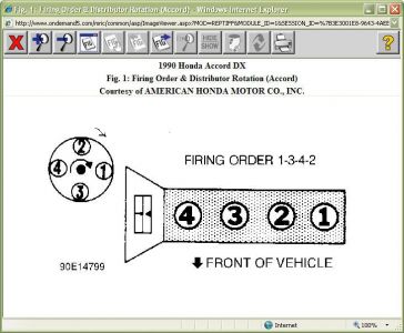

i have a 1990 honda accord lx 150000 miles it has the 4 cylinder. i just replaced the distrubutor and forgot to lable the fireing order i dont have a manual

https://images.2carpros.com/forum/automotive_pictures/12900_1990_honda_accord_firing_order_1.jpg
Courtesy of MItchell1 @ www. .com
