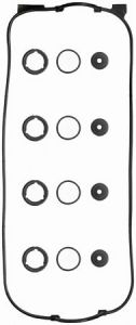

So i got the gasket set, and yes it has the valve cover seal, grommet set, spark plug tube seals and 4 other o ring type things. i was wondering what those replace. theey are similar in size to the sparkplug holes. any ideas? its a felpro brand set. i included the factory picture so maybe that will help thanks for all your help

The last orings that you are talking about will more than likely be for the injectors. That is your option to put them on and it surely won't hurt to do that.

Huh? Those are some pretty darn big injectors. Injector o-rings do not come in a valve cover kit for any honda 4cyl i've seen.
