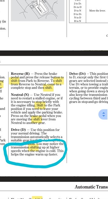

STEVEN WILLIAMS2
There could be lots of potential reasons for this.
Does this only happen after a cold start? Because this is normal if that's the case. Your owner's manual states that late shifts on a colder engine are designed to help raise the engine temperature up to normal operating temperatures.
If that's not the case, you should inspect all of the following:
1 - Dirty air filter
2 - Loose vacuum lines
3 - Mass airflow sensor
4 - Fuel pressure regulator
5 - Dirty throttle body
6 - Fuel Filter
7 - Fuel Pump
8 - Valve lash
9 - Fuel quality including presence of contaminants such as water. Expired or old fuel. Etc.
10 - Not likely but exhaust system issues such as obstruction or catalytic converter issues
