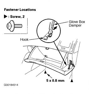

2008 Honda Accord Manual 15,000 miles
How does one unhook the damper on the right side of the glove box. I can't figure out what the damper is.
Sep 7, 2008 at 1:43 PM
KHLOW2008
  • 41,814 POSTS
Hi Ydfrnkel, Remove the screws and twist the damper lock out.
