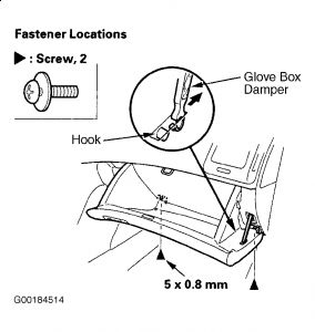

Where is it and how do I replace it? Thank you.

CABIN AIR FILTER Removal & Installation Open the glove box. Remove the damper from the glove box then let the glove box hang down. Remove the dust and pollen filter assembly from the evaporator case. Remove the filter from the housing and replace the filter. Install the filter in the reverse order of removal. Ensure arrow marks on edge of filter point in direction of air flow. Make sure that there is no air leaking out of the evaporator.
