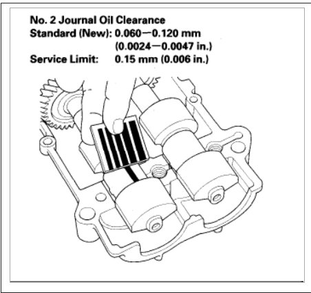

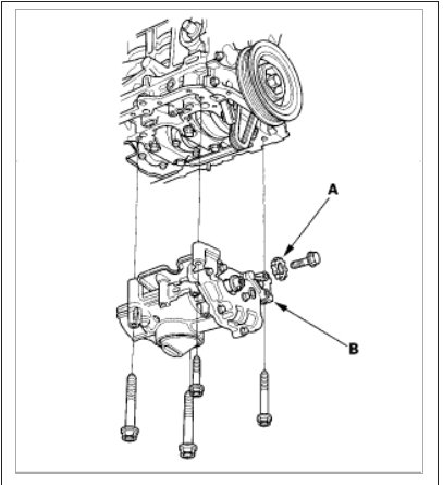

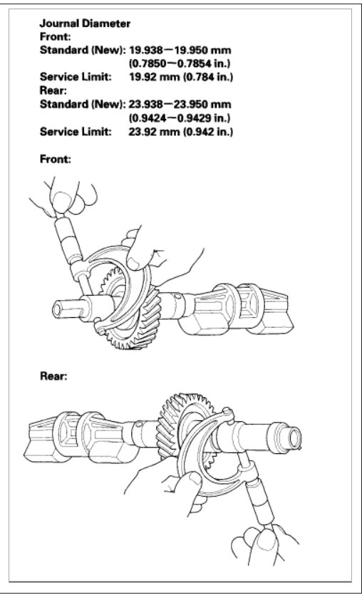

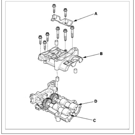

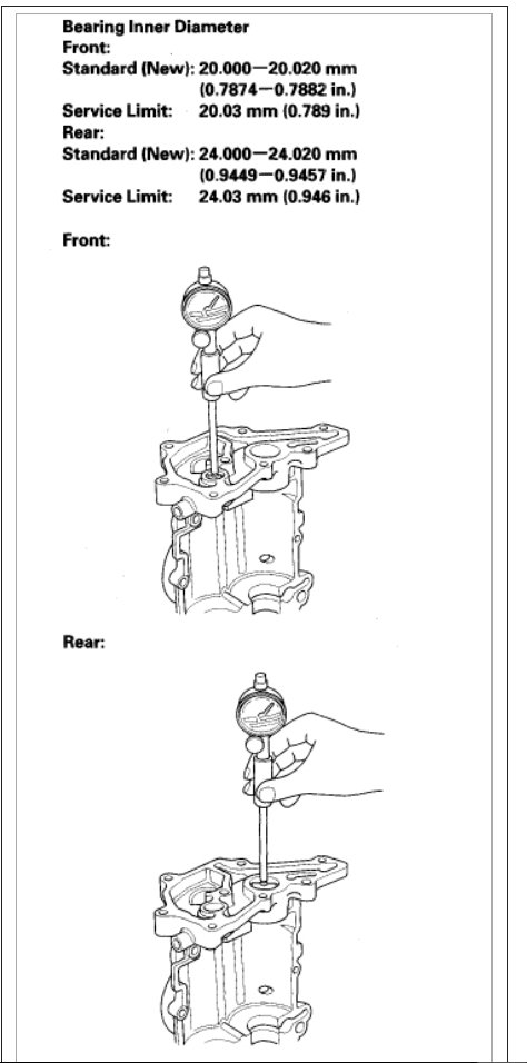

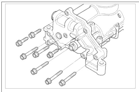

I took it to a different Honda shop and you where right the balance shaft housing has worn out causing the shafts to vibrate. Had it fixed for $850.00 but at least the car runs good again! thanks for your help
