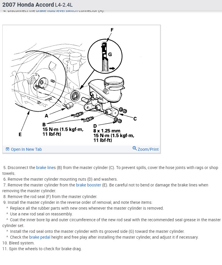

I got my pads replaced and the rear rotors turned. Now the brake pedal is softer than before -- I have to push it down further to stop. Is this normal?
Aug 16, 2009 at 8:45 AM
SQM
  • CAR REPAIR CONTRIBUTOR
  • 6,383 POSTS

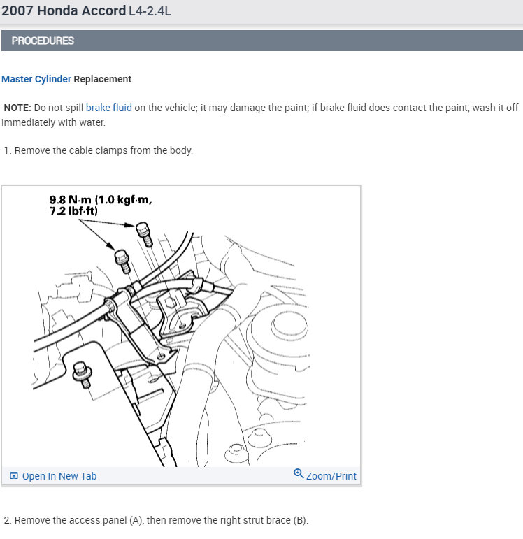

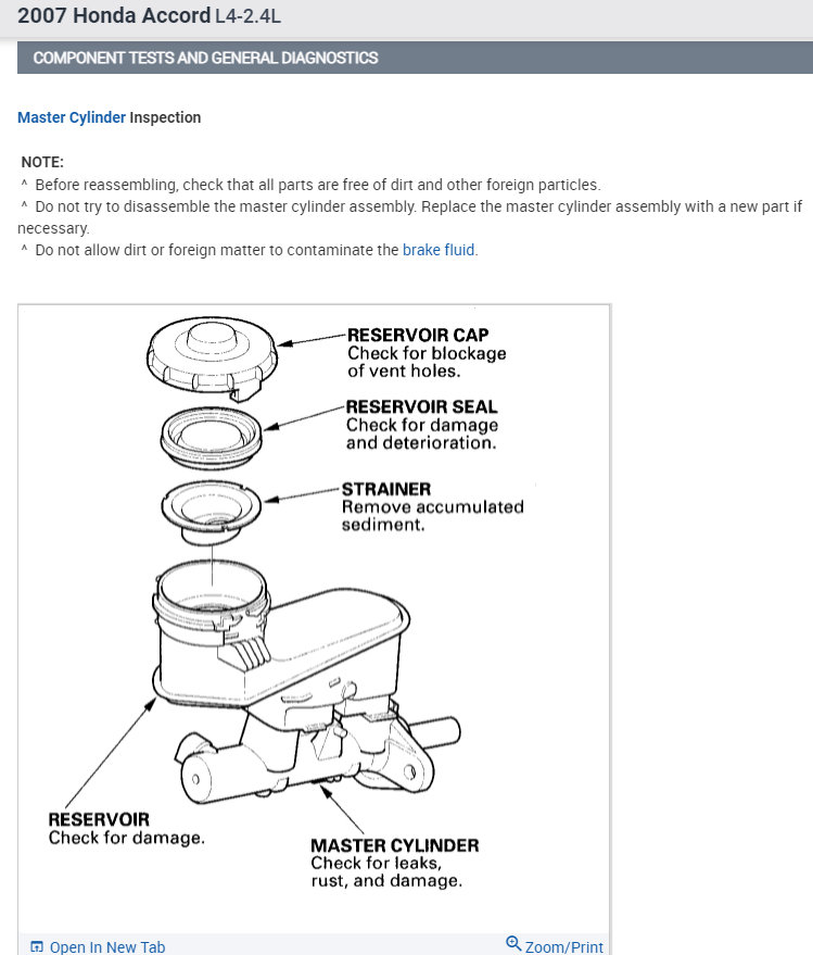

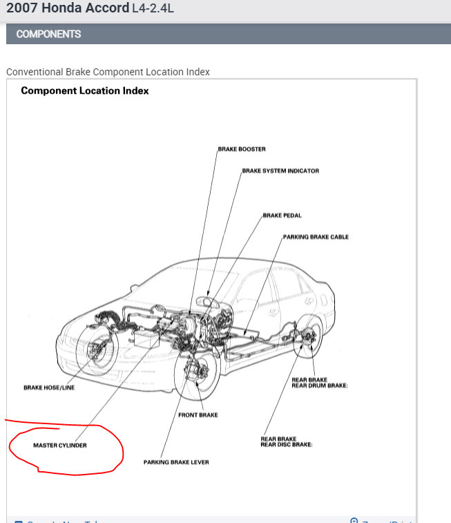

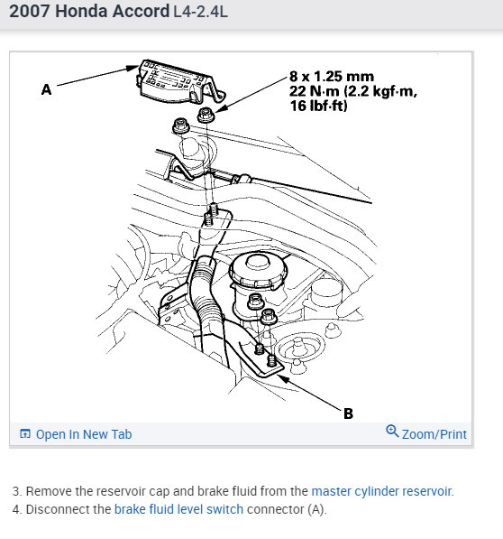

It is not normal to have soft brake pedals or a pedal that goes to the floor when depressed.
Soft brake pedal is can be cause by few reasons. It could be there is air trapped inside the brake lines, leak in the brake system, low on fluid or a bad master cylinder.
Here is a helpful article:
https://www.2carpros.com/articles/brake-pedal-goes-to-the-floor

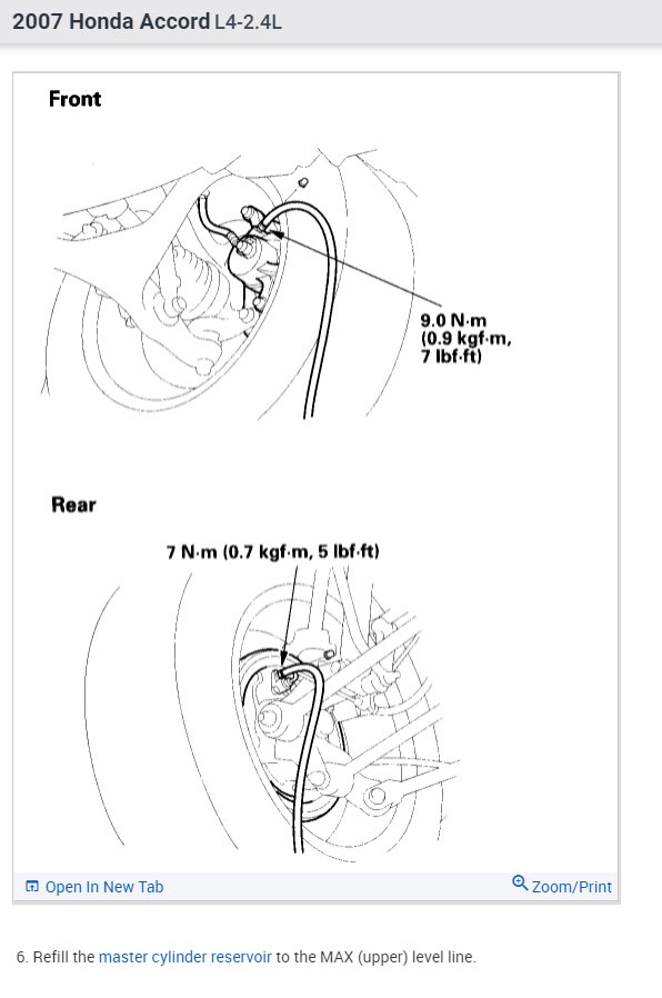

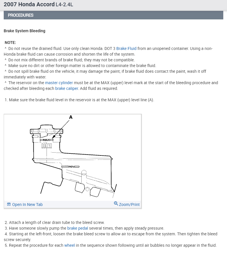

First make sure that the fluid is at the correct level. Also look for any leak, inspect the calipers as well as the brake lines.

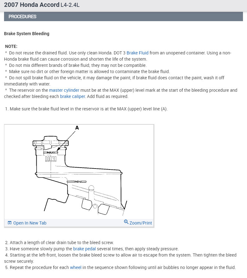

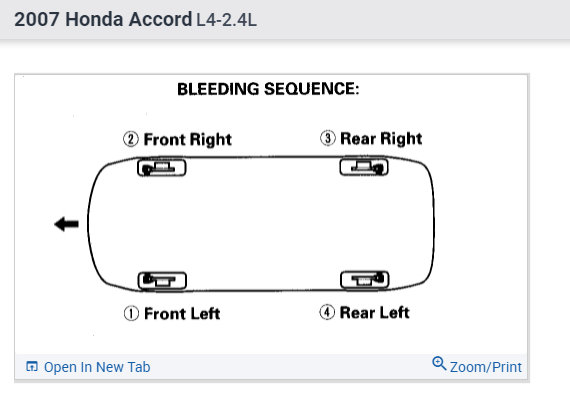

It will be good idea to bleed the brake system to purge out any air that might have gotten trapped.
https://www.2carpros.com/articles/how-to-bleed-or-flush-a-car-brake-system

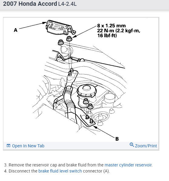

If there is no leak, fluid level is good, system has been bled but still having soft pedal, it is likely a bad master cylinder, as the master cylinder is unable to create pressure when the brake is applied.
https://www.2carpros.com/articles/how-to-replace-a-brake-master-cylinder
