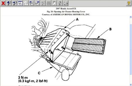

The video on your website does not show how to change a 2007 Honda Accord Air Filter.
You tell people to consult thier manual.
Well there is no information or picture in the owners manuel
Can you help me please

Hi jvon53, Unloosen the screws and remove the cover "A" and you can remove the air filter.
