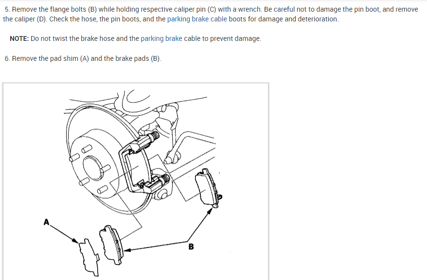

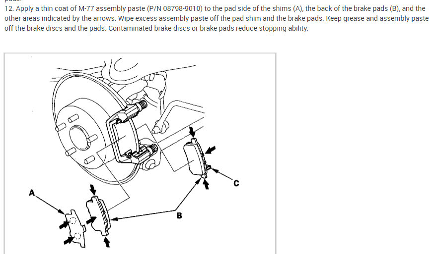

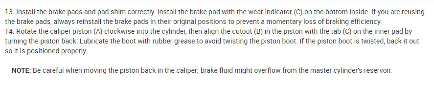

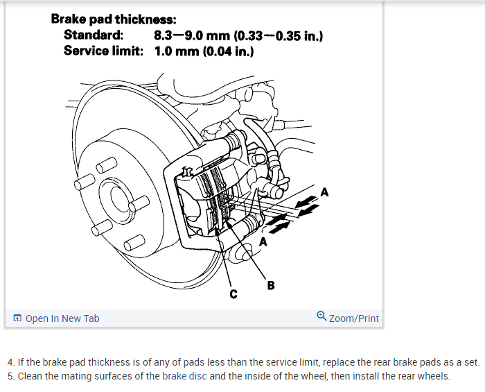

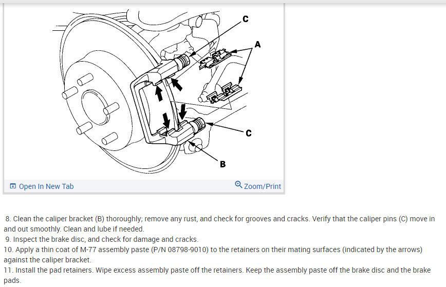

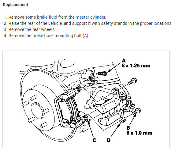

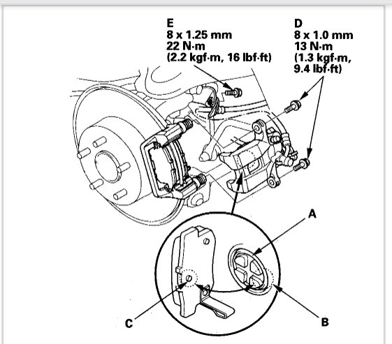

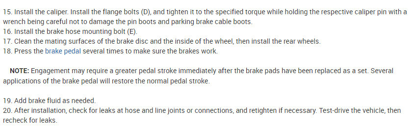

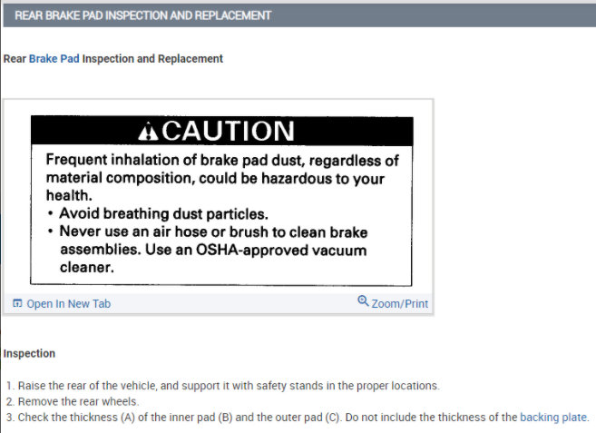

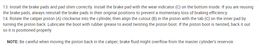

You will not need to lube the pads themselves but the slider pins are important. You will see where to lube in the picture steps below. Here is a tutorial showing how to replace the rear brake pads and rotors:
https://www.2carpros.com/articles/how-to-replace-rear-brake-pads-and-rotors
Here is a YouTube video from our site showing how to compress the rear caliper piston.
https://youtu.be/j8YwfSKEzZo
I've attached picture steps below showing how to replace the rear brake pads and rotors on your car. Hope this helps and thanks for using 2CarPros.
