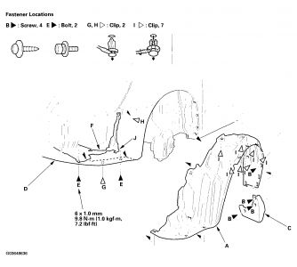

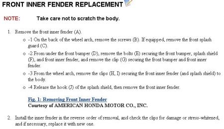

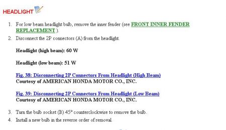

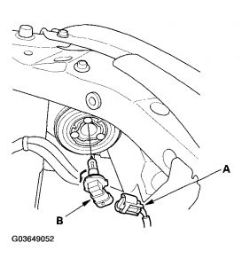

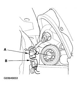

headlight lamp change
2006 HONDA ACCORD
30,000 MILES • 6 CYL • FWD • AUTOMATIC
TARA SULLIVAN
how do i change the light bulb
Feb 22, 2009 at 8:03 AM
ZACKMAN
  • 4,202 POSTS
https://images.2carpros.com/forum/automotive_pictures/55316_06accordheadlight_1.jpg
https://images.2carpros.com/forum/automotive_pictures/55316_06accordhighbeam_1.jpg
https://images.2carpros.com/forum/automotive_pictures/55316_06accordlowbeam_1.jpg
https://images.2carpros.com/forum/automotive_pictures/55316_06accordinnerfender_2.jpg
https://images.2carpros.com/forum/automotive_pictures/55316_06accordinnerfender_1.jpg
