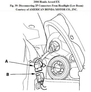

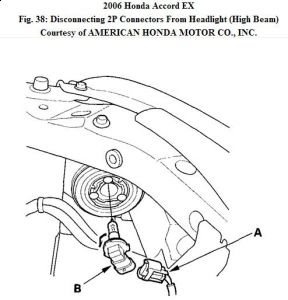

How do I change the front left headlight light bulb

HEADLIGHT BULB REPLACEMENT 1. For low beam headlight bulb, remove the inner fender. 2. Disconnect the 2P connectors (A) from the headlight. Headlight (high beam): 60 W Headlight (low beam): 51 W

3. Turn the bulb socket (B) 45 ° counterclockwise to remove the bulb. 4. Install a new bulb in the reverse order of removal.
