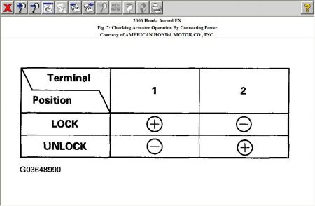

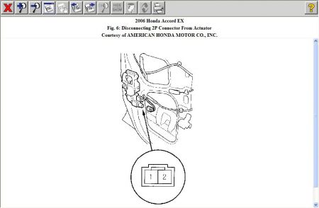

I push the button to lock my doors and they driver side will not lock. I used my key to lock the driver's side and the door will not lock. The passenger side will lock, but not the driver side.

Hi safety, Seems the door actuator is faulty, DOOR LOCK ACTUATOR TEST DRIVER'S DOOR 1. Remove the driver's door panel. 2. Disconnect the 2P connector from the actuator. 3. Check actuator operation by connecting power and ground according to table figure below. To prevent damage to the actuator, apply battery voltage only momentarily. 4. If the actuator does not operate as specified, replace it.
