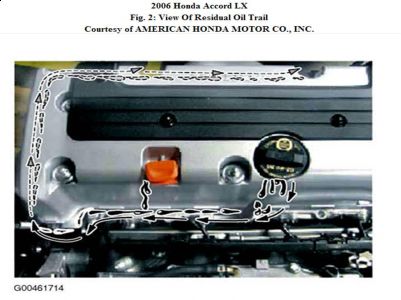

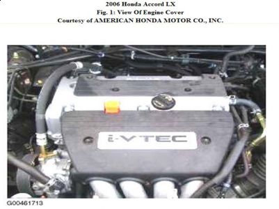

Hello - Thank you very much for the info........ Okay, this model has a TSB discussing possible this problem. I have attached it for you. This may be the problem and not a leaking valve cover. See what you think.......... LEAKING HEAD COVER GASKET MAY JUST BE A RESIDUAL OIL TRAIL SERVICE NEWS Reference Number(s): 08040L, Date of Issue: April 1, 2008 Affected Models: 2003-08 L4 Accord, 2006-08 Civic Si, 2007-08 CR-V, and 2003-08 Element Related Ref Number(s): 08040L ARTICLE BEGINNING SERVICE INFORMATION Lately, we've been seeing a rise in warranty claims for replacement of leaking head cover gaskets. Most of those claims were for repairs that were done around the first oil change interval. Results of Warranty Parts Inspection (WPI) analysis shows that over 80 percent of those head cover gaskets tested No Trouble Found (NTF). From dealer visits, we've pinpointed the problem to residual oil around the oil fill hole and the oil dipstick tube. It makes a trail around the head cover, and with the engine cover in place, it looks like the head cover gasket is leaking. Fig. 1: View Of Engine Cover Courtesy of AMERICAN HONDA MOTOR CO., INC.
https://images.2carpros.com/forum/automotive_pictures/248015_1_174.jpg
If you think you've got a leaking head cover gasket, don't rush off to replace it. Instead, pull the engine cover and look for a trail of residual oil stemming from the oil fill hole and the dipstick tube. If that's what you see, clean it off and you're done with this repair. Of course, if it looks like there's really a leak, then replace the gasket. But keep in mind that if you return a gasket to WPI and it winds up testing NTF, your claim will be debited. Fig. 2: View Of Residual Oil Trail Courtesy of AMERICAN HONDA MOTOR CO., INC.
https://images.2carpros.com/forum/automotive_pictures/248015_2_116.jpg
You are correct in thinking it a little odd that with the little miles it has.......why the leak. Good thinking on your part. Let me know what you think about the TSB.

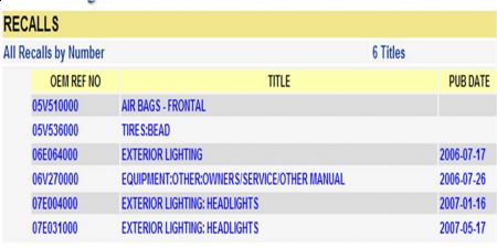

Hello - Also, while we are talking about TSBs, it looks like this may have some recalls. The dealer may fix these for free. Please contact the dealer service department, give them the VIN number of the car and have them check on these to see if they apply.
https://images.2carpros.com/forum/automotive_pictures/248015_Recalls_36.jpg
I would definitely check the Air bags one.
