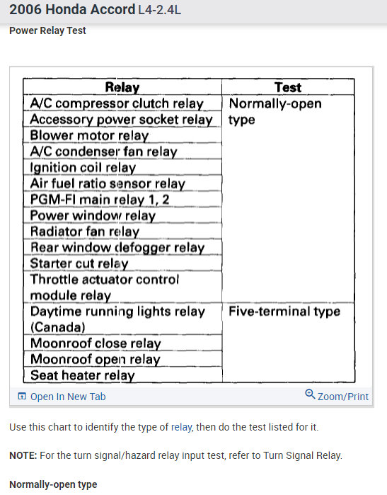

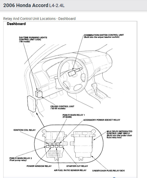

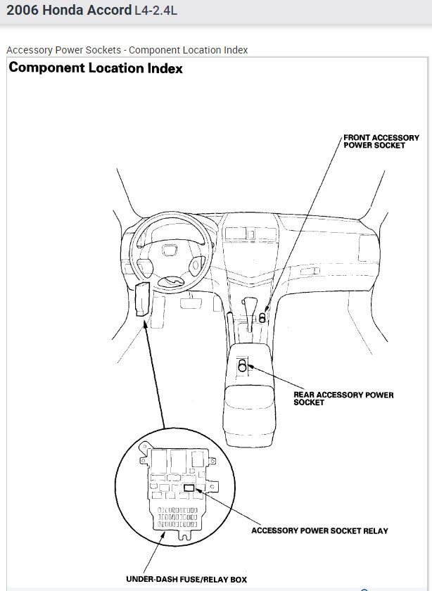

Check the relay for the accessory power outlet.
The relay is located on the driver side kick panel to the left (see diagram).
First do a visual inspection for any corrosion or burnt pin(s).

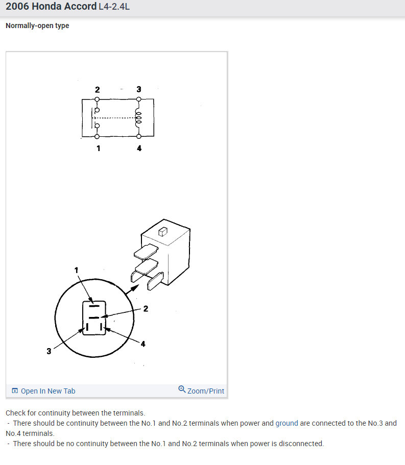

You can also test the functionality of the relay.
Here is a helpful article:

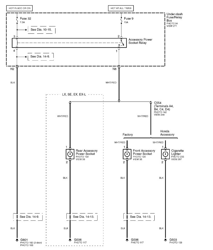

If the relay is good, then you might have a wiring issue. Check to see if you are getting power to the connector of the accessory outlet. If you do not have power, then you will have to trace the wires for any short or open.
