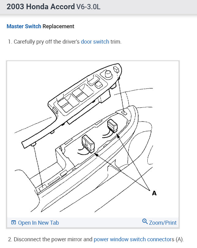

i need to replace the power window switch in the drivers door its a 2 door coupe. what is the best way to remove the door panel?

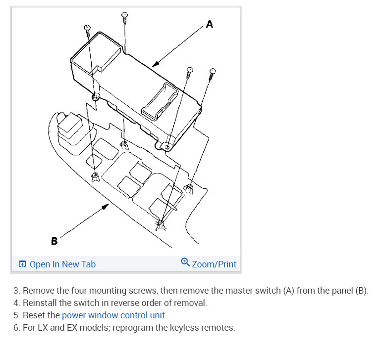

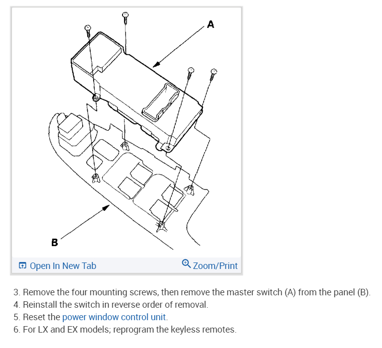

You don't have to remove the door panel to replace the master switch. Check out the instructions in the diagrams below.

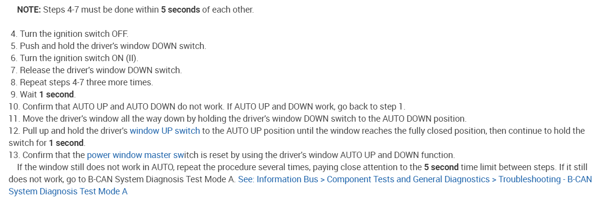

I just installed a new driver's side window switch. The windows work perfectly again - thank goodness. But my problem is that my key fob lock/unlock and trunk opener doesn't work. Do I need to reset something in the car to get the window switch to recognize my key fob? Help please.

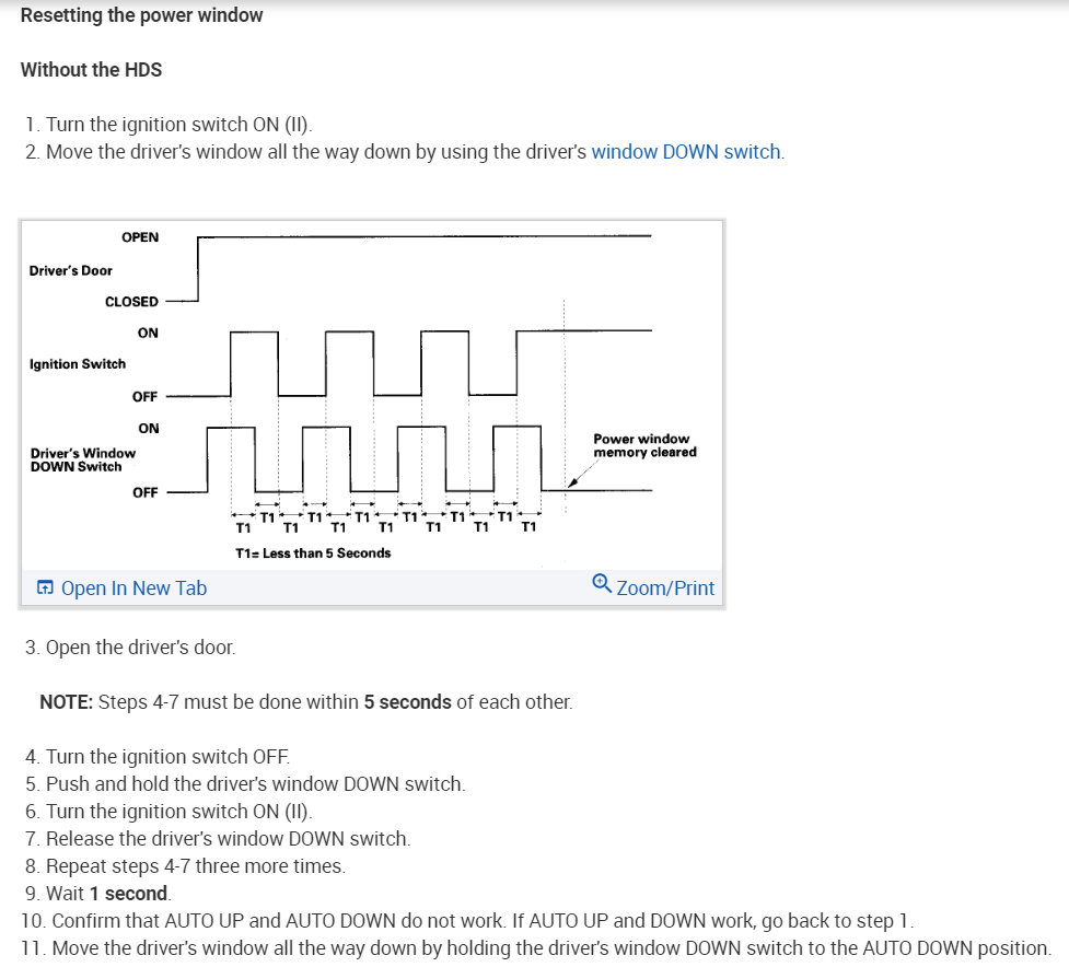

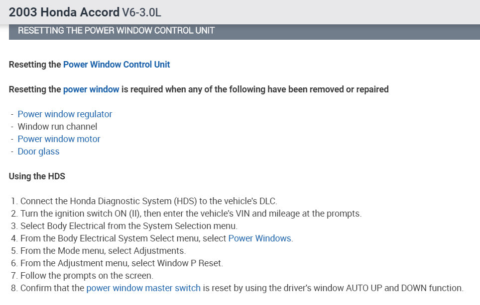

The Window switch control module must be reset here are the instructions on how to replace the switch correctly and how to set it up. Check out the diagrams (Below). Please let us know if you need anything else to get the problem fixed.

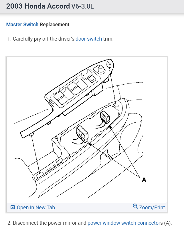

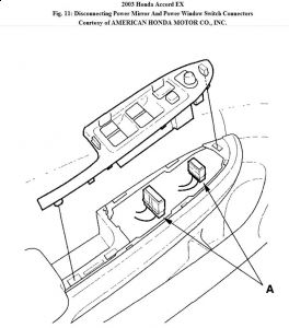

I have confirmed that my driver's side power window switch on my 2003 accord 2-door EX coupe V6 is bad and needs to be replaced. Can you pls provide instructions on how to replace the switch? Do I need to remove the door panel, and if so, how?
Thanks
Jul 31, 2019 at 1:49 PM (Merged)
KHLOW2008
  • 41,814 POSTS
Hi mlemise, The switch is pluggged in and can be removed by carefully prying it out. Note the locking tabs position. Unplug the connectors ( A) after prying the switch out and it can be replaced.
https://images.2carpros.com/forum/automotive_pictures/192750_SwitchMaster03AccordFig11_1.jpg

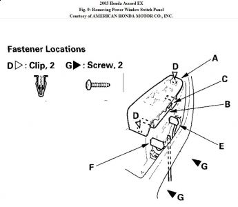

Thanks for the info, but this diagram is for a 4-door. Mine is the 2-door coupe, and the set-up is completely different
KHLOW2008
  • 41,814 POSTS
Sorry for the error. Here are the 2-door procedures. 2-DOOR Remove the power window switch panel (A). â—¦ -1 Insert a flat-tip screwdriver wrapped with protective tape through the hole under the armrest, and push up the bottom of the power window switch (B) to release the panel. â—¦ -2 Pull out along the edge of the panel to release the hook (C) and clips (D). â—¦ -3 Disconnect the power mirror switch connector (E) (driver's) and the power window switch connector (F).
https://images.2carpros.com/forum/automotive_pictures/192750_SwitchMaster03AccordFig09_1.jpg
