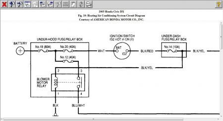

On my way to work my air was working as usual with no problems, when i got off work absolutely NO air would come out of any of the vents. What could cause this problem?
Jul 29, 2010 at 2:52 PM
  • 75,992 POSTS
Hi cunderhill, Welcome to 2carpros and TY for the donation Check and test all the fuses listed below and test the relay before we go technical-we start here
https://images.2carpros.com/forum/automotive_pictures/12900_honda_AC_1.jpg
