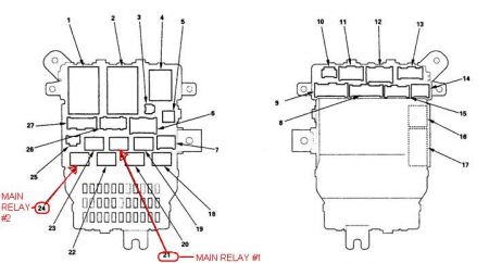

2005 Honda Accord 4 cyl Two Wheel Drive Automatic
locate remove and replace main fuel
relay
Jun 11, 2009 at 6:56 AM
BLUELIGHTNIN6
  • 16,542 POSTS
Your vehicle has two main relays. They are both located in the under-dash fuse/relay box. To replace relay, simply pull it out (much like a fuse) and insert new relay.
https://images.2carpros.com/forum/automotive_pictures/261618_Noname_525.jpg
