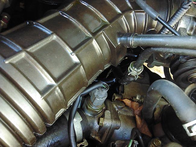

CLARKBEAR
My car seems to be leaking antifreeze from some where in the back of the engine. I've been trying to find proper diagram pictures that would pinpoint which of the hoses is causing the problem. I took a picture of where I suspect the leak is. It's right around the EVAP two way valve.
Jan 2, 2020 at 12:12 PM (Merged)
HMAC300
  • 48,601 POSTS
from your pic it looks like the one pointed to with the arrow check all of yoru hoses however for being soft as they will leak if soft soon.
