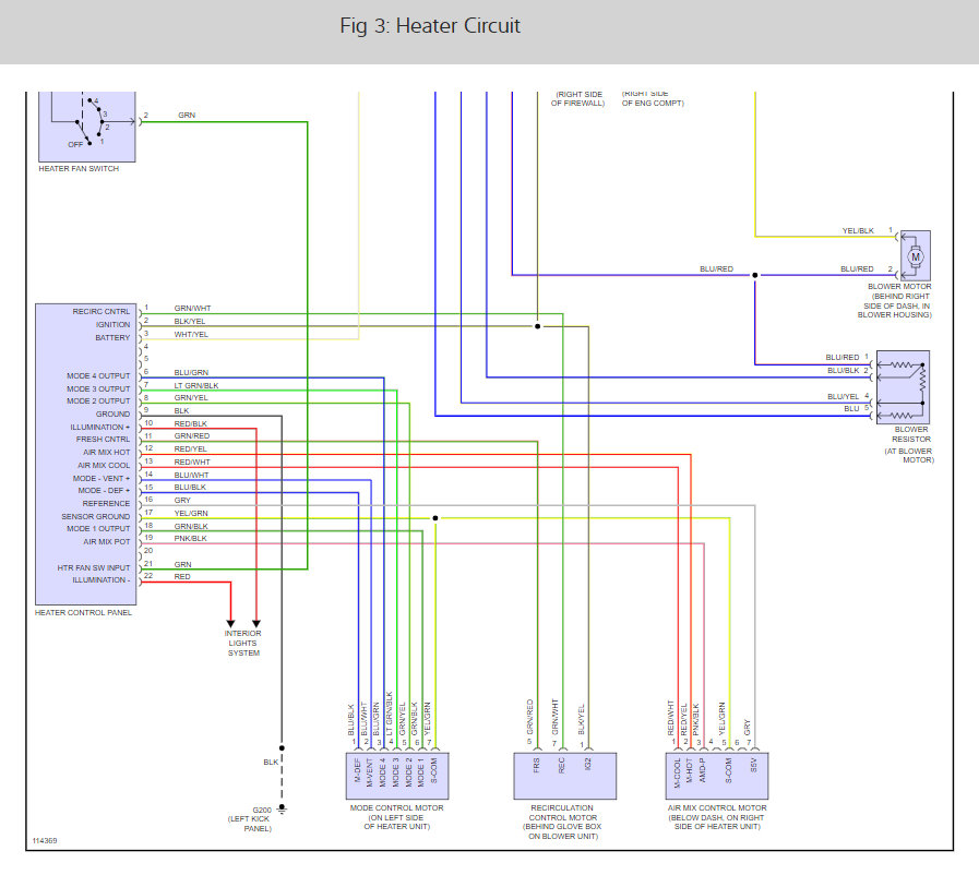

My radio and climate control lights have gone out and I have checked the fuses and they all appear fine. the radio and climate controls work fine just no lights. Any suggestions?
Jan 24, 2009 at 3:52 AM
KHLOW2008
  • 41,812 POSTS
Hi Robsta,
Either the backlight bulbs have fused or the wire connectors to them are bad. You need to remove the control and radio to check.

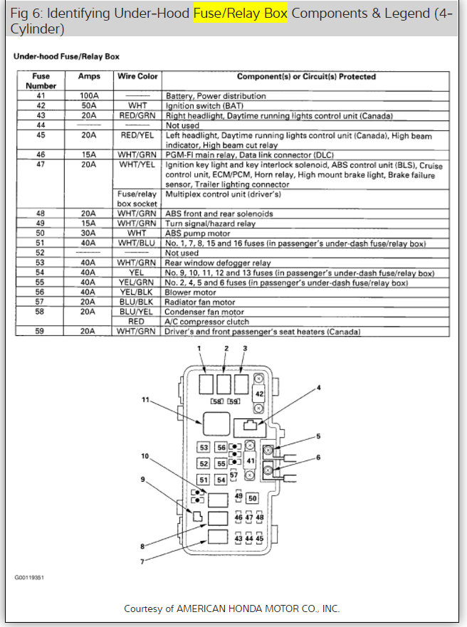

KHLOW2008
  • 41,812 POSTS
Hi kevinp1,
You mean all the interior lights are not working? Courtesy lights, instument cluster, dome?
Check Fuse # 32 and 33 for power supply with ignition switch turned to ON.

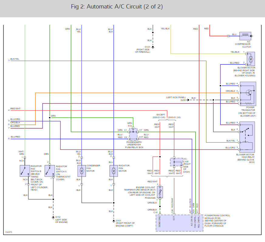

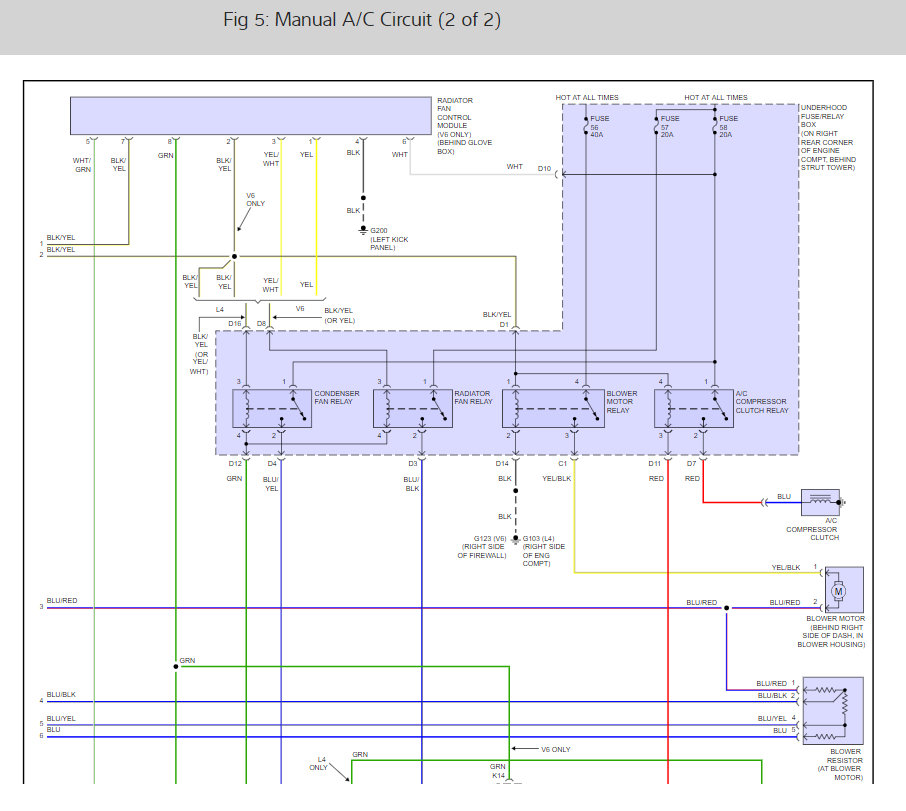

TWGRAVER
It's hot in Atlanta and my AC isn't helping. Hot air blows from the driver's side vents. Cooler air (but not as cold as would be normal) blows from the passenger side. No control mode nor fan or AC setting seems to change this. My mechanic says the AC mechanical system is performing correctly (per his test equipment).
Any ideas?
Oct 23, 2019 at 6:42 AM (Merged)

KHLOW2008
  • 41,812 POSTS
Hi twgraver,
I believe it is the air venting system that is not working well.
Over time of usage, the sponge sealing the vents might have worn off resulting in air leakage internally.
This would result in inaccurate air mix for the AC thus different temperature from the vents.
It could also be the air mix control unit that is faulty thereby providing wrong vent opening and closing.
Does the heater work ok?
Does setting the AC temp at different level changes anything?

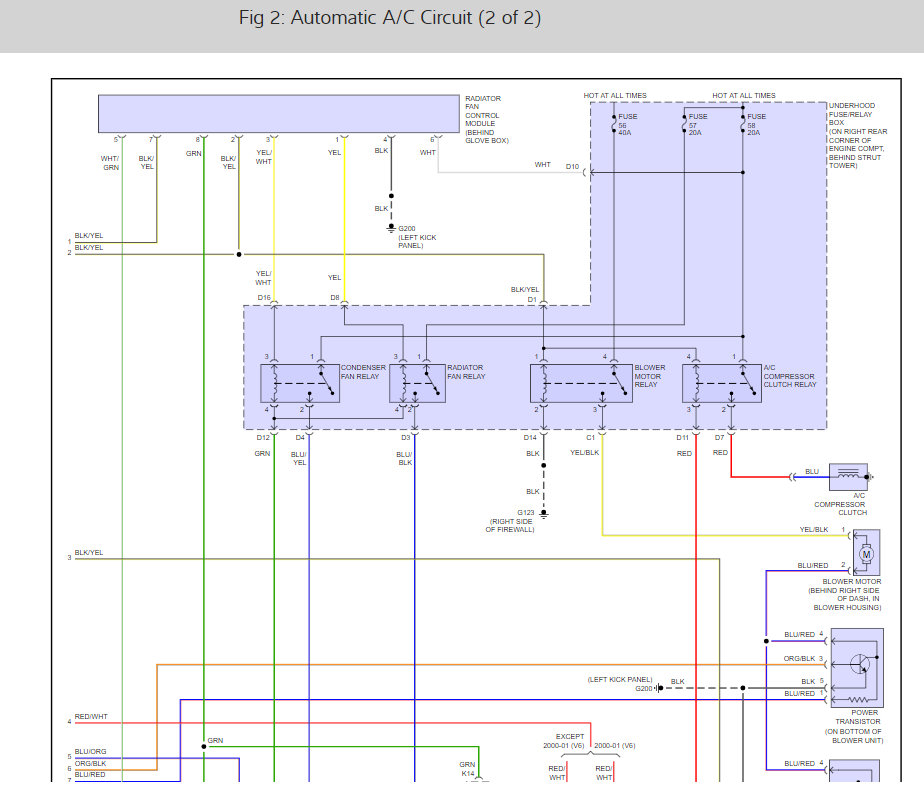

RLEWIS14
The wife's 2004 honda accord coupe's heater system operates intermittently. The heater will not put out heat on a consistent basis. The temperature gauge is indcating the engine is properly warmed and the blower motor is functioning, however the car feels as though the AC is on. Took the car to the dealer last winter and they replaced the climate control unit. The heater system appeared to work for a short period, but the problem returned. Took it back to the dealer and their remedy was to replace the blower motor. The blower motor works fine, so we passed on their suggestion. On a few occasions, we have had the heater to work, but not nearly consistent enough to trust it. Winter is here and I am not sure how to remedy the problem. Have anyone experienced this same problem and if so, were you able to fix the problem?
Thanks,
Ron in Bowie, Maryland

KHLOW2008
  • 41,812 POSTS
Hi Ron,
Possibly the air mix motor is not functioning correctly. Check them for binding and intermittent failure.

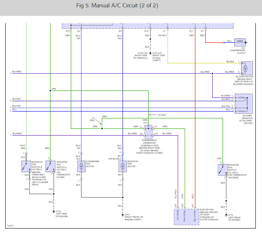

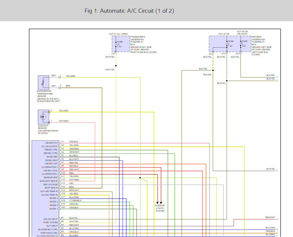

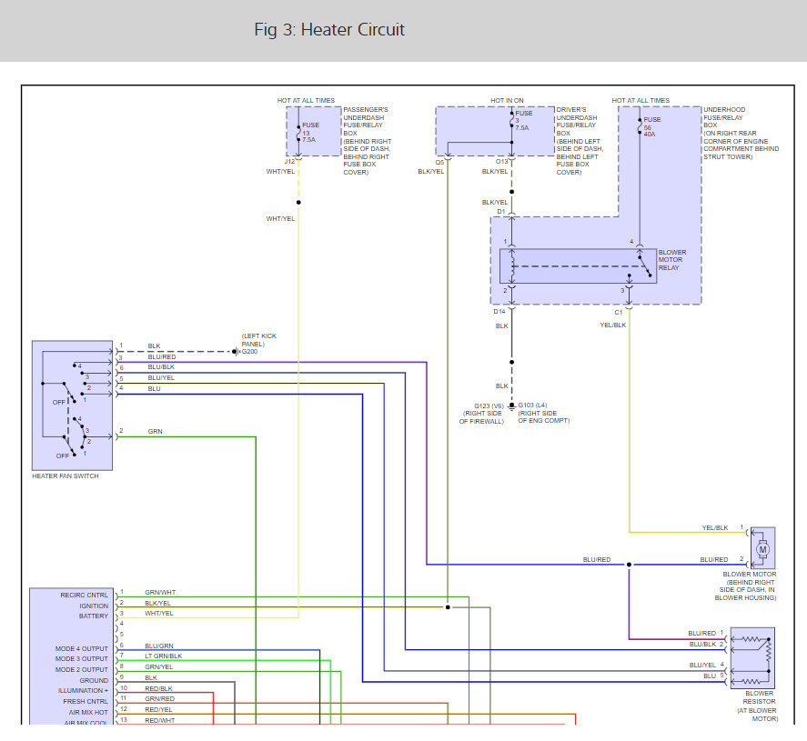

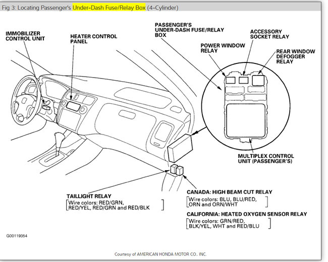

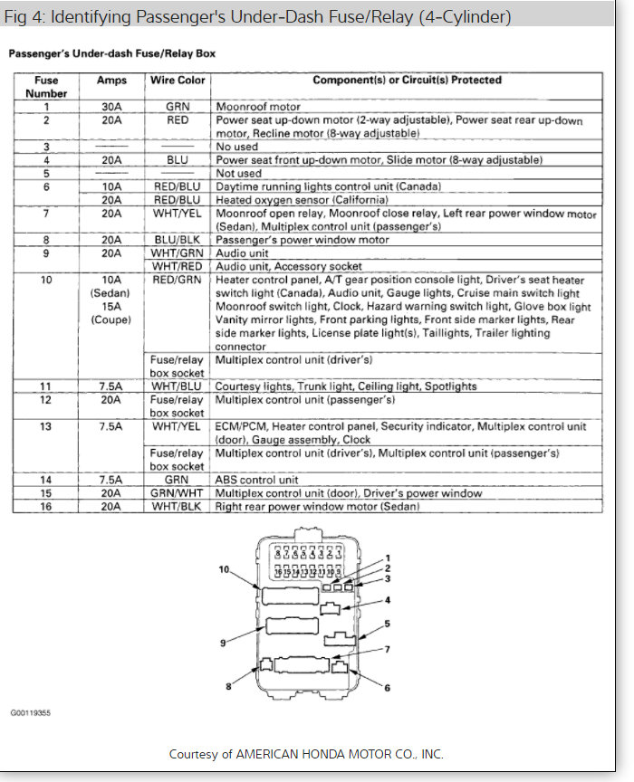

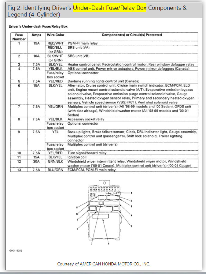

What fuse or fuses power the climate control on a 2000 Accord EX?
After the number, and amp. Thanks
HMAC300
  • 48,601 POSTS
There are several fuses that run the HVAC system. Here is a guide to help you check them and the heater and air conditioner wiring diagrams so you can see how the system works and which fuses to check below:
Cheers
BOOPERIII
Thanks for this post is was fuse #56 all fixed. I love this site!

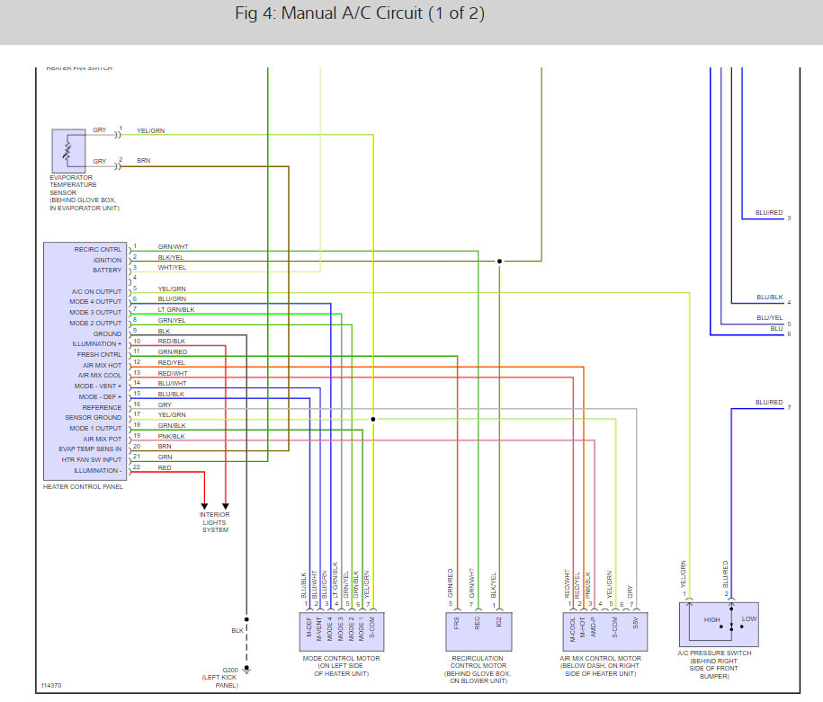

MARIO2176
My climate controls are not working. They have no power. I can't switch the vents and I only get hot air. I've checked all the fuses in the engine compartment and the fuse box near the driver's side door.
2CARPRO JACK
  • 11,533 POSTS
There is also a fuse block on the passenger side, check fuse 13 it is a 7.5 amp with a test light.This is the battery power to the unit.If it is good, your climate unit may be bad, but you would need to remove it and verify power at the unit first

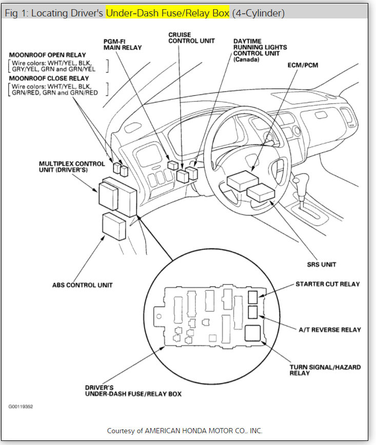

JMLONG2985
  • 5 POSTS
although i've had the car for a few years now, still learning to do a lot of the work myself. within the last few weeks or so, my car has been having some lighting issues. the dimmer switch has been going from bright to completely dark even though my headlights are still on. while I can deal with it, it is rather annoying. I have noticed that if I play with the dimmer switch it will try to correct itself. any ideas for that part? now to my next question. within the last couple of days I've noticed that my climate control lights have been staying on, dimly mind you, even after I turn the car off and remove the key. I did notice that the control knob was broken after I pulled it off. going to order a replacement as no auto parts store around my area carries anything other than domestics. anyhow, this issue has drained my battery on more than 3 occasions. at one point I thought it went away as playing with the buttons got it to finally get it to go away, but alas to no avail. im running out of ideas. ive pulled fuses and visually inspected them. nothing. I know it has to be a short somewhere. any idea? also approximate cost for parts?
Oct 23, 2019 at 6:43 AM (Merged)
KHLOW2008
  • 41,812 POSTS
Seems like the dimmer circuit is affecting the A/c control as well.
Try puling the taillight relay or fuse and see if the A/c panel lights goes off.
JMLONG2985
  • 5 POSTS
not to sound dumb but where would it be located? I have a Haynes(-_-) manual but it doesn't tell me the locations of relays or certain fuses
KHLOW2008
  • 41,812 POSTS
Fuse # 32 in underhood fuse box.

JMLONG2985
  • 5 POSTS
its labeled as the small light 15A fuse correct?
KHLOW2008
  • 41,812 POSTS
Yes, that is the one. Since it did not turn the light off, you would need to remove the A/C control panel and perform testings from there. Check for the source of the power and ensure ground circuits are good.
