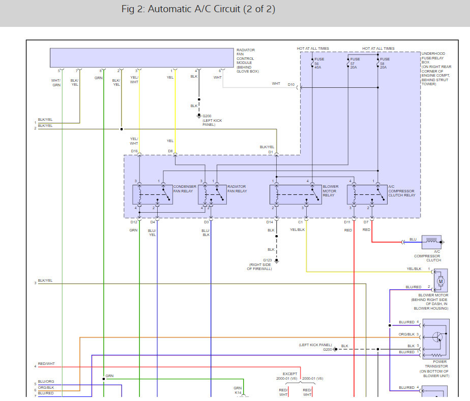

My radio and climate control lights have gone out and I have checked the fuses and they all appear fine. the radio and climate controls work fine just no lights. Any suggestions?

Hi Robsta,
Either the backlight bulbs have fused or the wire connectors to them are bad. You need to remove the control and radio to check.

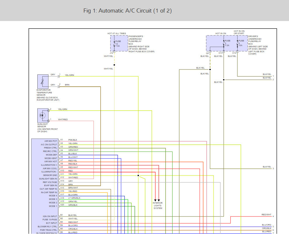

My Radio/Climate Control display and lights are not working. I checked Fuse #6(interior lights) located inside car but it looks good. can you please tell me what could be wrong?
Oct 23, 2019 at 1:42 PM (Merged)
KHLOW2008
  • CAR REPAIR CONTRIBUTOR
  • 41,814 POSTS
Hi kevinp1,
You mean all the interior lights are not working? Courtesy lights, instument cluster, dome?
Check Fuse # 32 and 33 for power supply with ignition switch turned to ON.

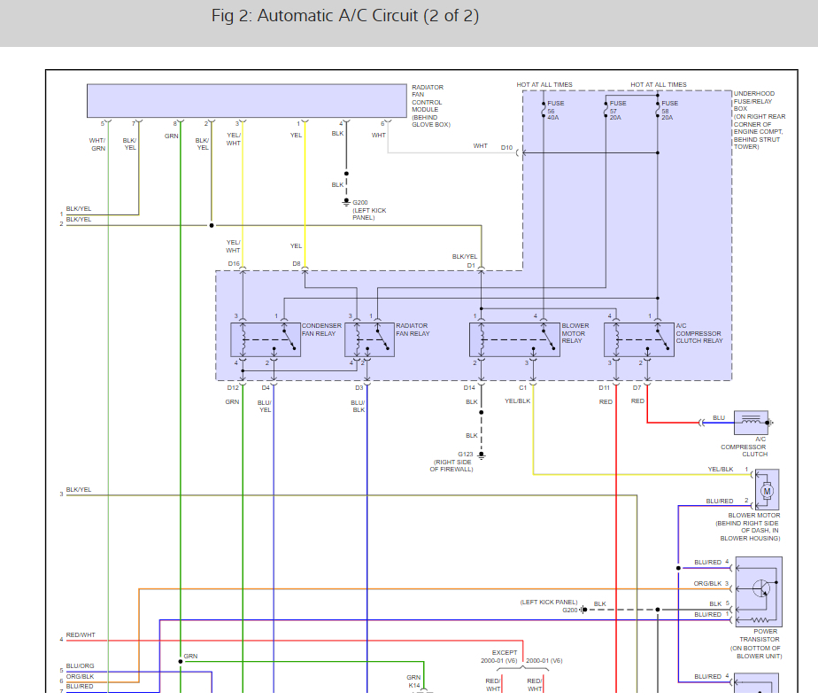

What fuse or fuses power the climate control on a 2000 Accord EX?
After the number, and amp. Thanks
HMAC300
  • 48,601 POSTS

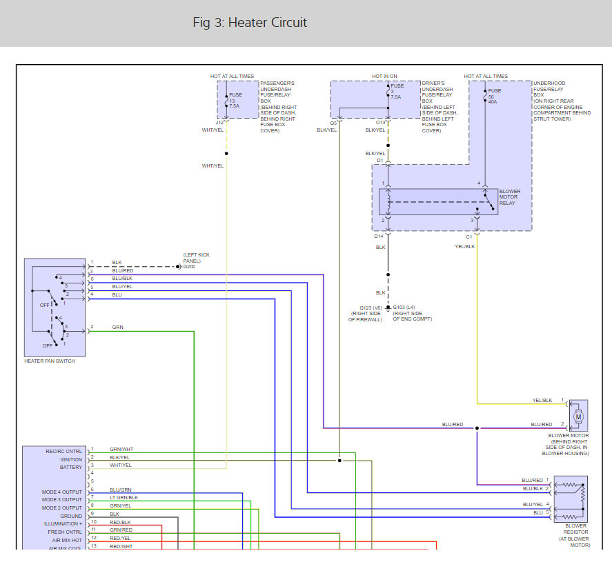

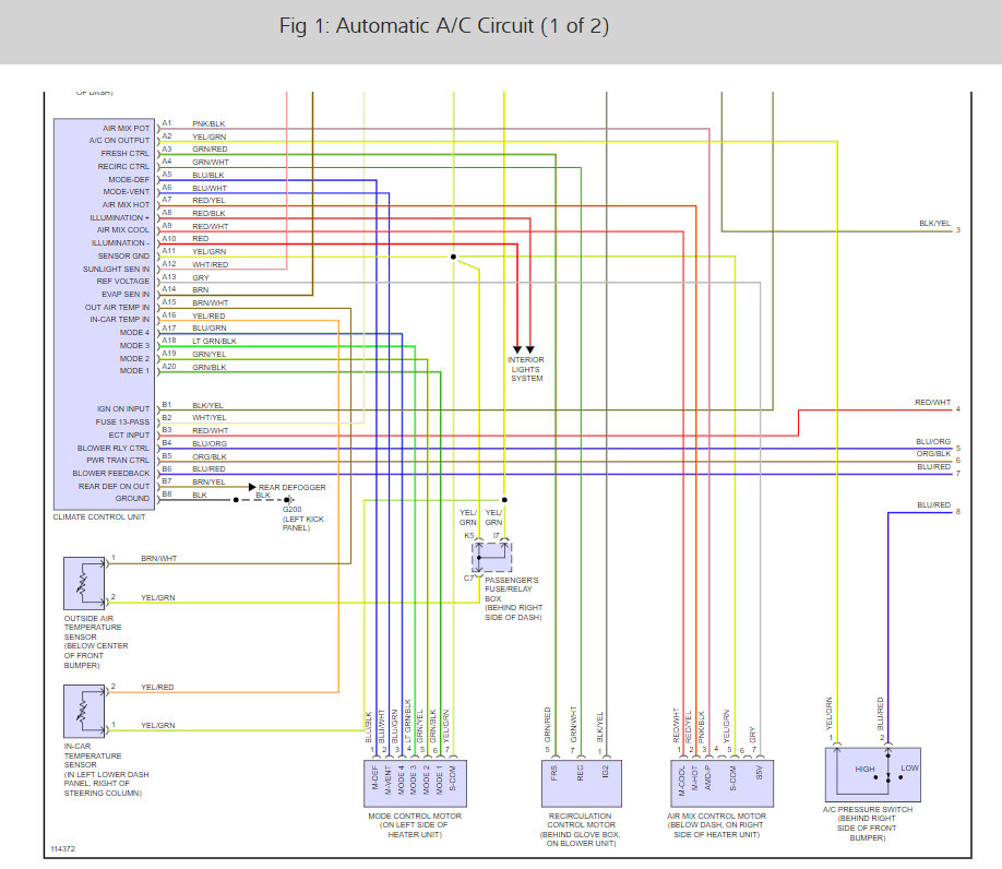

There are several fuses that run the HVAC system. Here is a guide to help you check them and the heater and air conditioner wiring diagrams so you can see how the system works and which fuses to check below:
Cheers

MARIO2176
My climate controls are not working. They have no power. I can't switch the vents and I only get hot air. I've checked all the fuses in the engine compartment and the fuse box near the driver's side door.
2CARPRO JACK
  • 11,533 POSTS

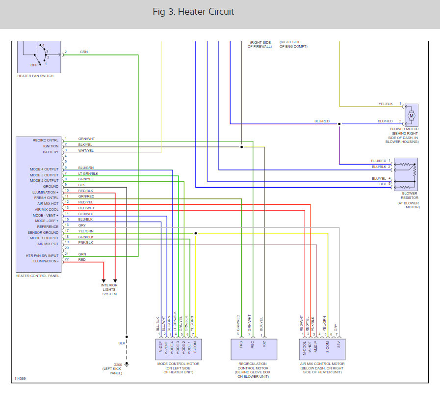

There is also a fuse block on the passenger side, check fuse 13 it is a 7.5 amp with a test light.This is the battery power to the unit.If it is good, your climate unit may be bad, but you would need to remove it and verify power at the unit first

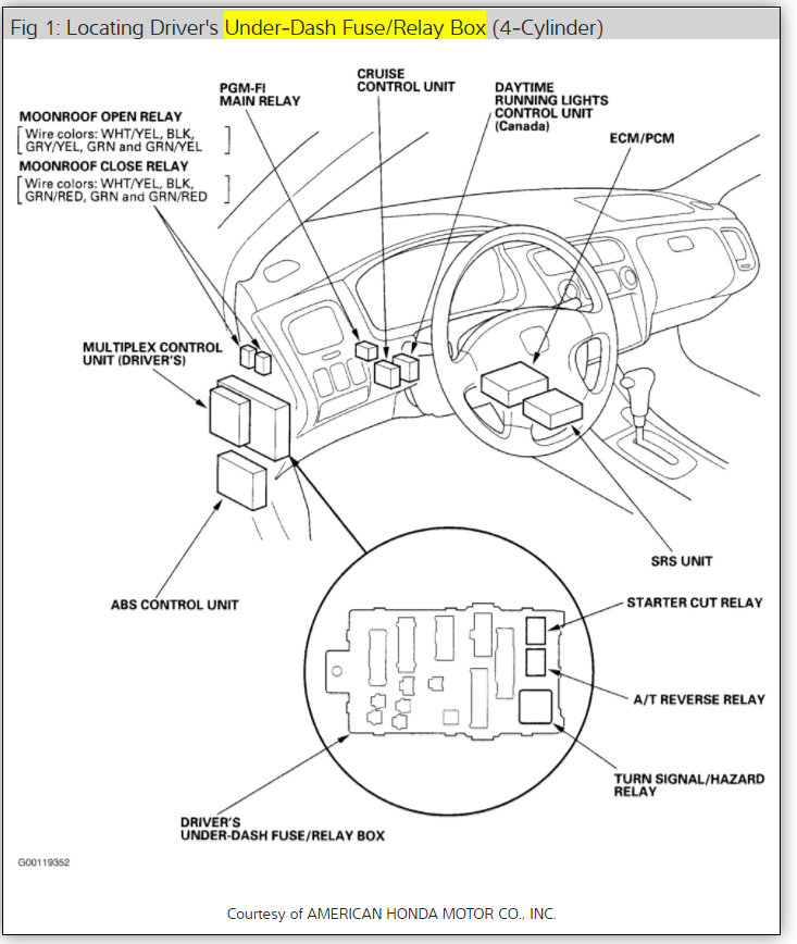

JMLONG2985
  • 5 POSTS

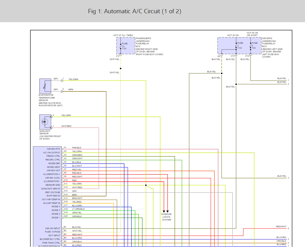

although i've had the car for a few years now, still learning to do a lot of the work myself. within the last few weeks or so, my car has been having some lighting issues. the dimmer switch has been going from bright to completely dark even though my headlights are still on. while I can deal with it, it is rather annoying. I have noticed that if I play with the dimmer switch it will try to correct itself. any ideas for that part? now to my next question. within the last couple of days I've noticed that my climate control lights have been staying on, dimly mind you, even after I turn the car off and remove the key. I did notice that the control knob was broken after I pulled it off. going to order a replacement as no auto parts store around my area carries anything other than domestics. anyhow, this issue has drained my battery on more than 3 occasions. at one point I thought it went away as playing with the buttons got it to finally get it to go away, but alas to no avail. im running out of ideas. ive pulled fuses and visually inspected them. nothing. I know it has to be a short somewhere. any idea? also approximate cost for parts?

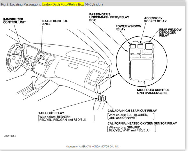

Seems like the dimmer circuit is affecting the A/c control as well.
Try puling the taillight relay or fuse and see if the A/c panel lights goes off.
Oct 23, 2019 at 1:43 PM (Merged)
JMLONG2985
  • 5 POSTS
not to sound dumb but where would it be located? I have a Haynes(-_-) manual but it doesn't tell me the locations of relays or certain fuses

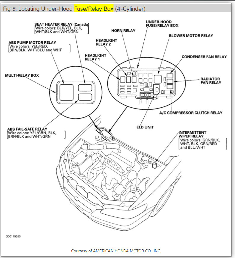

KHLOW2008
  • 41,814 POSTS
Fuse # 32 in underhood fuse box.
JMLONG2985
  • 5 POSTS
I pulled the fuse and inspected all around it. all are in good condition. also none of the lights went out.
JMLONG2985
  • 5 POSTS
its labeled as the small light 15A fuse correct?
KHLOW2008
  • 41,814 POSTS
Yes, that is the one. Since it did not turn the light off, you would need to remove the A/C control panel and perform testings from there. Check for the source of the power and ensure ground circuits are good.
