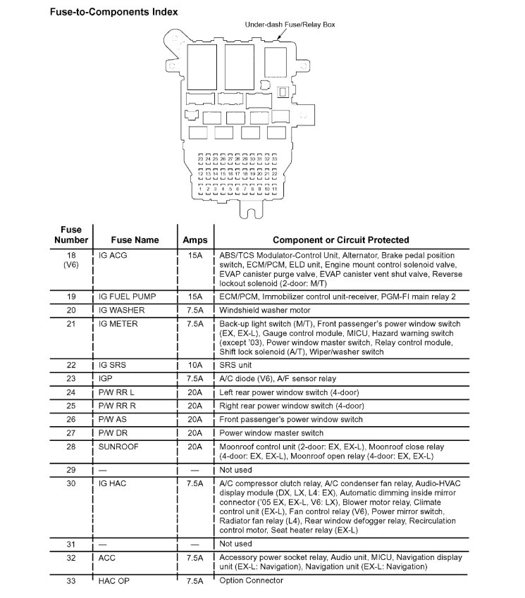

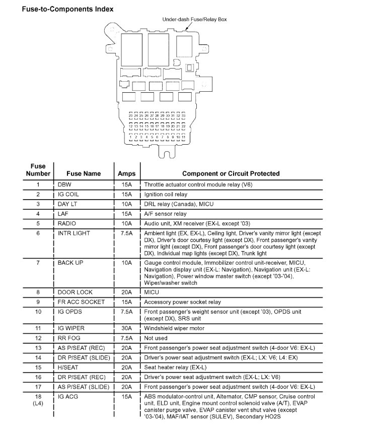

I was plugging into the cigarette lighter to get power for my iPod when the LED indicator suddenly dimmed off---no more power access but the car starts, drives and the CD/radio plays OK. Hmmm...there was no UFO around. What could be wrong? Thanks a lot!
Dec 26, 2008 at 9:42 PM
BMRFIXIT
  • 19,053 POSTS

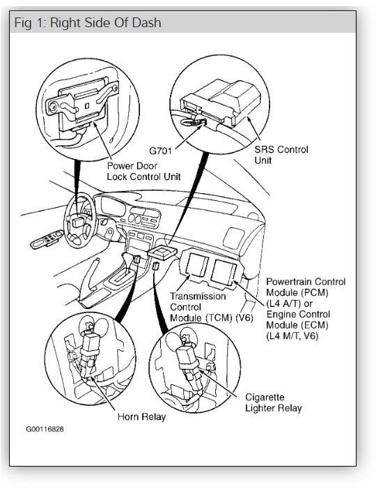

There is a power accessory relay and fuse #9 15 amp in the kick panel fuse panel, here are two guides to help test and the fuse and relay location as well
and
Check out the diagrams (Below). Please let us know what you find. We are interested to see what it is.
Dec 26, 2008 at 11:45 PM
JOHNS2
i had to replace the relay everything works again! Thanks for the guides they really help.

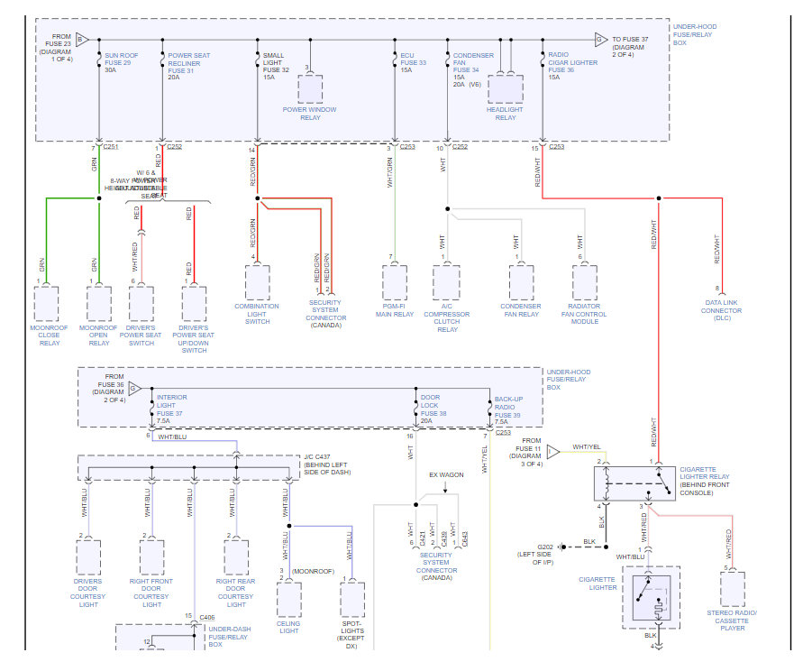

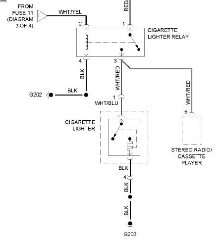

PATENTED_REPAIR_PRO
  • 1,853 POSTS
The cigarette lighter could have a bad wire or ground. Use a voltmeter or 12 volt test light and check for voltage. Check out the diagrams (Below). Please let us know if you need anything else to get the problem fixed.

  • 54,850 POSTS
There is a cigarette light power relay that needs to be checked. here is a guide to help you with the relay location:
Check out the diagrams (below). Please run this test and get back to us.
