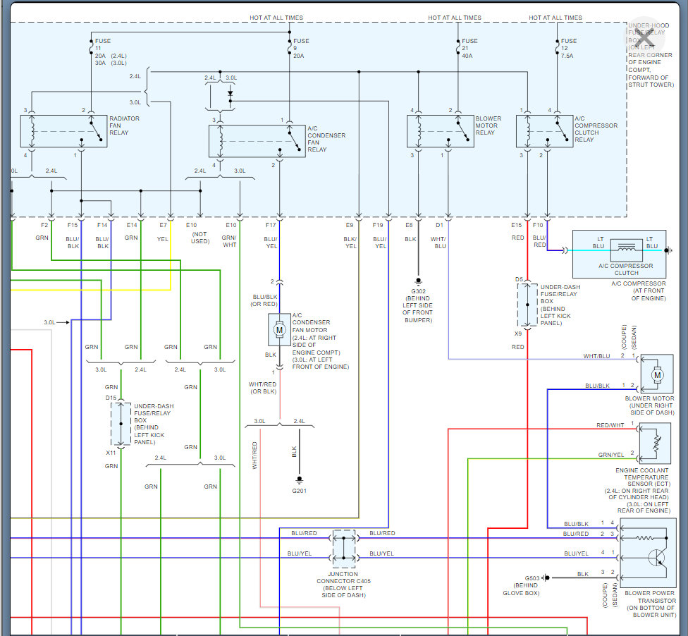

No air is coming out of any of the vents. It doesn't matter if the heat, air or defrost is on nothing comes out. We have checked the blower motor and resistors, fuses but still does not work. Any suggestions? I do not have a lot of money and I really need to fix this. Thank you

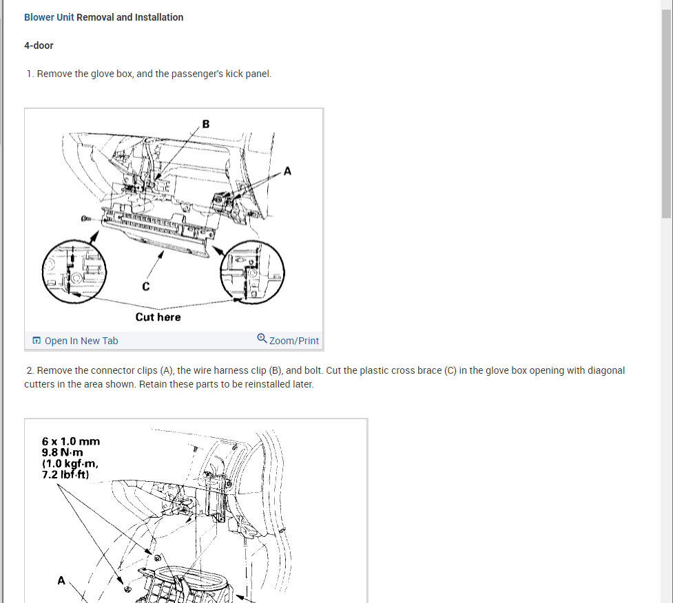

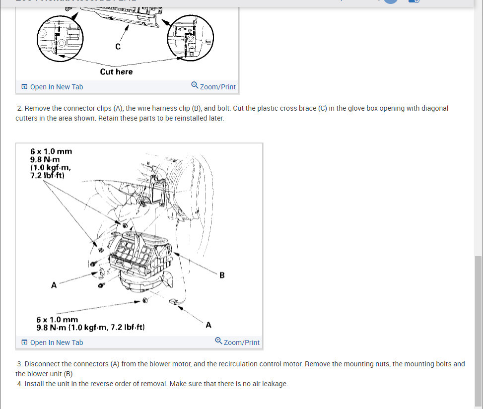

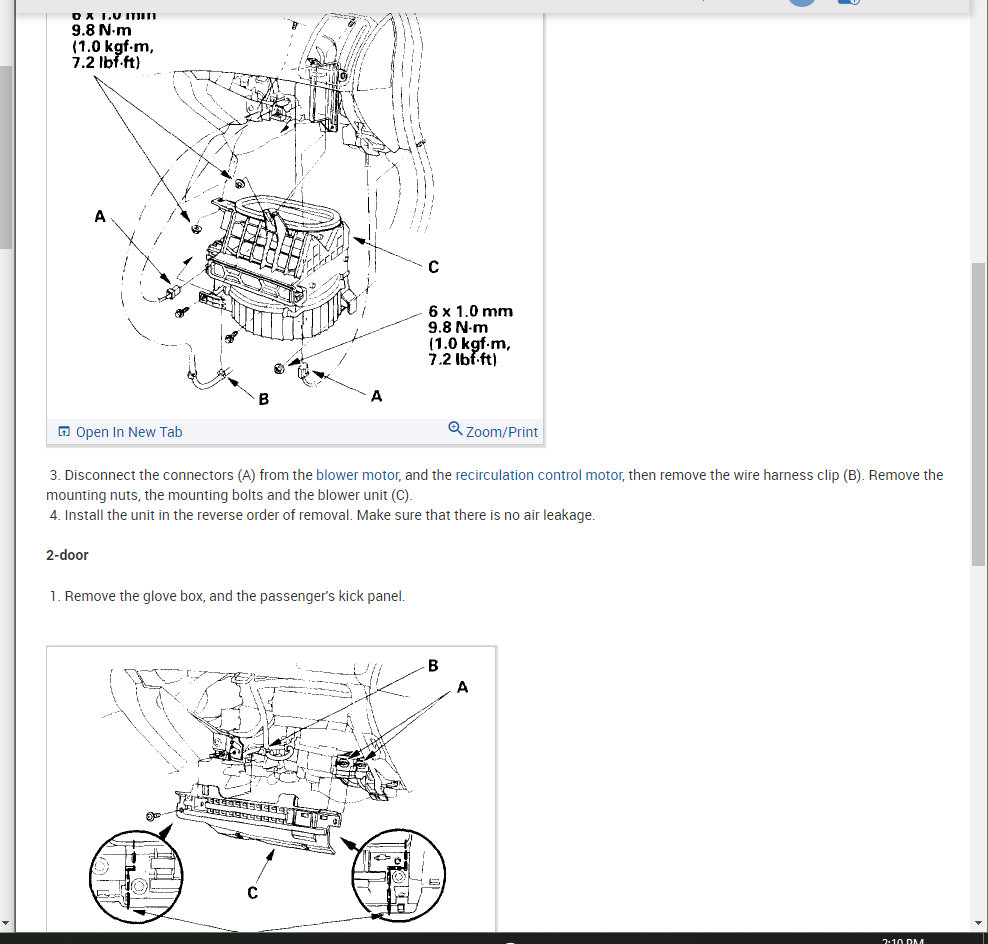

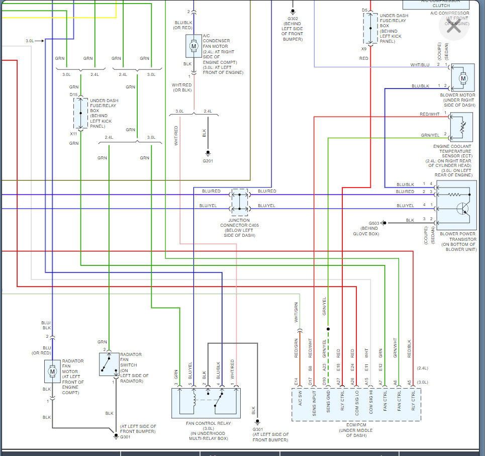

I attached the wiring diagram below for your review. Also the process from the manual that will help with specifics on how to replace the blower motor if this proves out.
