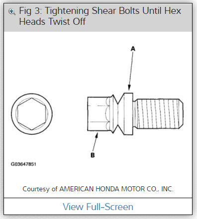

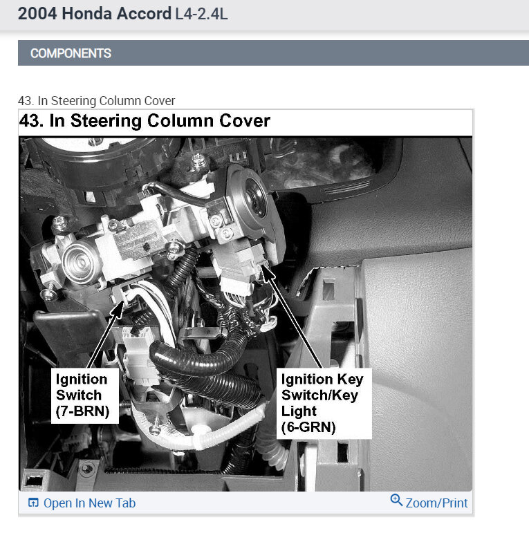

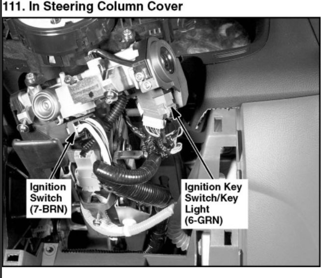

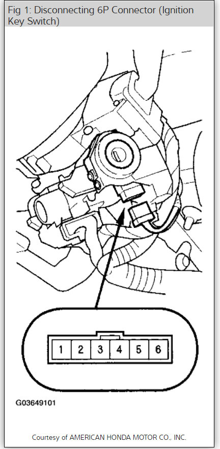

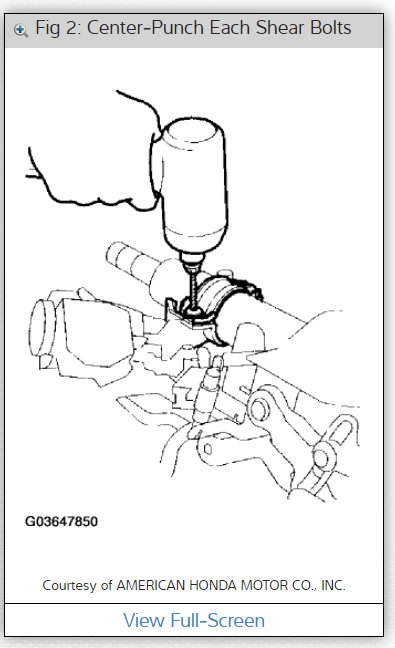

I would try WD40 in the tumber first work the key around but it sounds like the key and tumbler has gone bad which is common here are diagrams and instructions on how to change it out. Check out the diagrams (Below). Please let us know if you need anything else to get the problem fixed.

Yep, the ignition lock needs to be replaced, I would get a new one from the dealer so they can program it for you before installation. have your VIN number ready. Here is what it looks like, so you get the right part. Check out the images (below). Let us know what happens and please upload pictures or videos of the problem.
