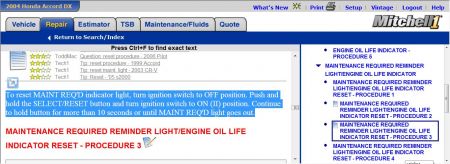

Need to reset engine needs maintance light
Jun 20, 2010 at 11:26 AM
Experienced Mechanic
75,988 POSTS
See below-Good Luck
