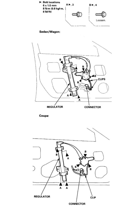

The cable in the window regulator broke. Can I just replace this part or do I need a whole new motor/regulator system? Also is it possible to dismantle the metal frame in the door to work on the window motor?

You need to replace the regulator it's broken.I found a regulator with motor for 47 plus shipping.No you can't take the door apart you just have to work around the sheet metal in the door. This video will give you an idea on how to change out the motor and regulator.

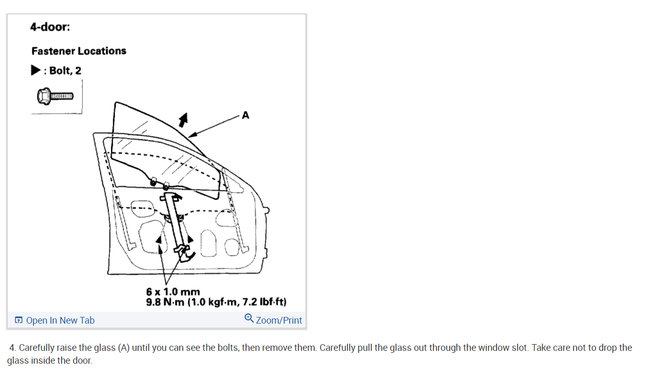

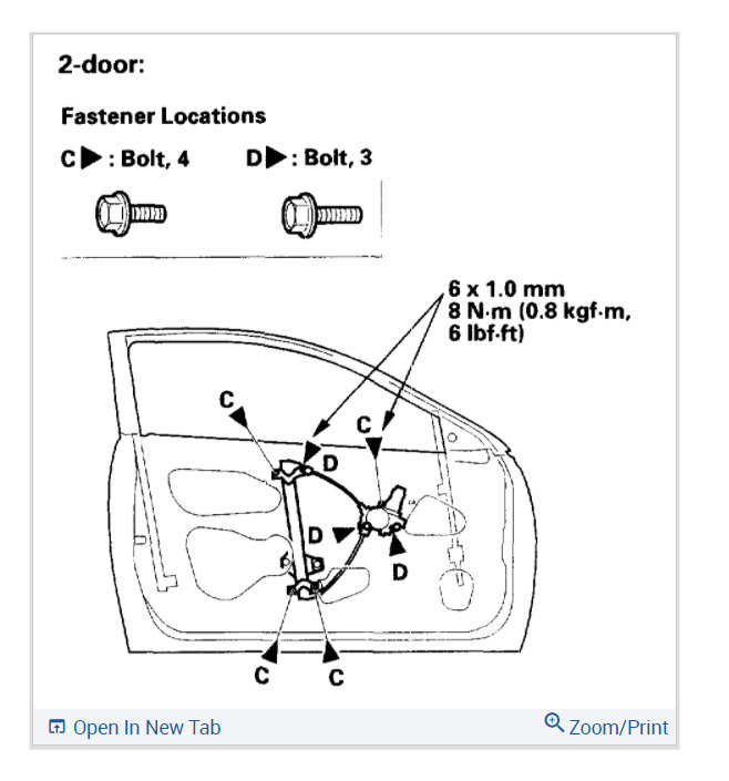

KHLOW2008
  • 41,814 POSTS
Hi tster57t,

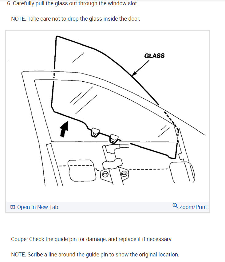

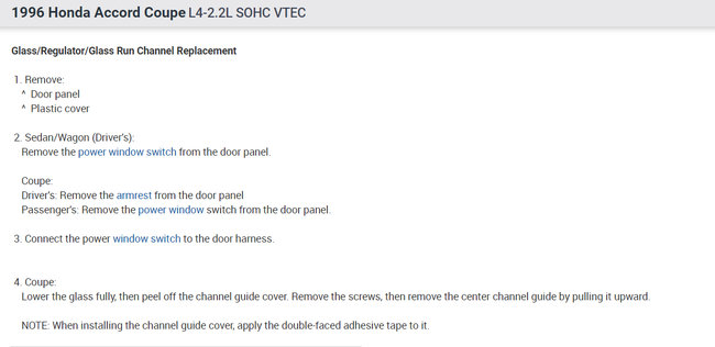

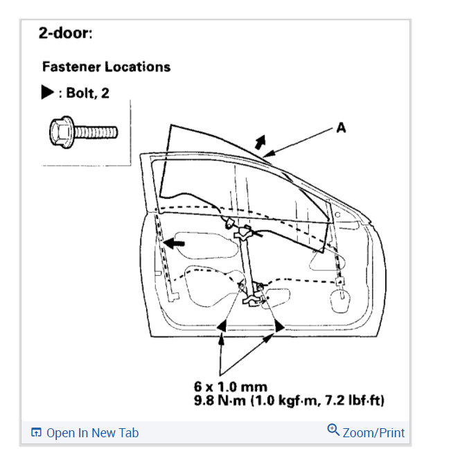

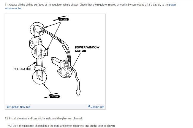

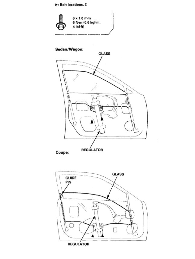

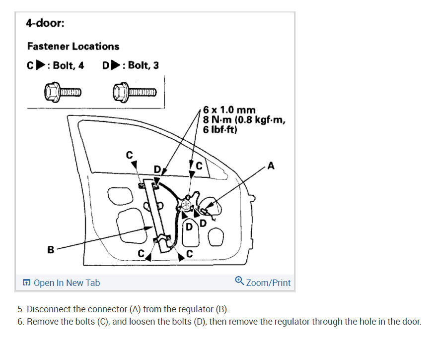

The motor is to be replaced as an assembly with the regulators. I have the replacement instructions for the window motor and regulator in the diagrams below. Check out the diagrams (Below). Please let us know if you need anything else to get the problem fixed.

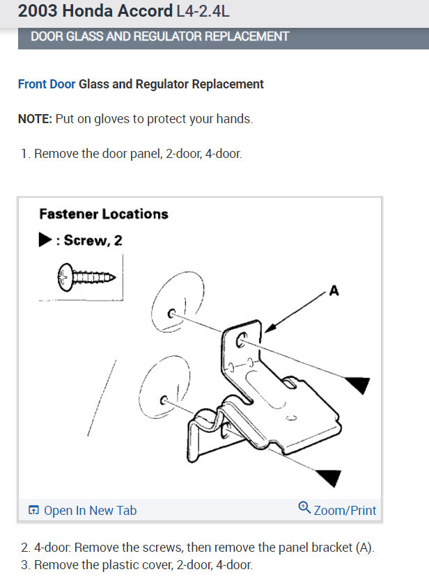

BLUELIGHTNIN6
  • 16,542 POSTS
To replace the motor you have to remove the regulator from the door.
Remove the door trim panel.
Remove the screws securing the pull pocket bracket. If equipped with power windows, remove the nut securing the center stiffener.
Remove the plastic cover (vapor barrier).
CAUTION
When removing the window, be very careful not the drop the glass inside the door!
Carefully raise the glass until the bolts are visible, then remove the bolts. Carefully pull the glass out through the window slot.
disconnect and detach the connector and harness clip from the door. Remove the bolts then remove the regulator through the hole in the door.
Installation is the reverse of the removal procedure.
Oct 14, 2020 at 6:33 AM (Merged)

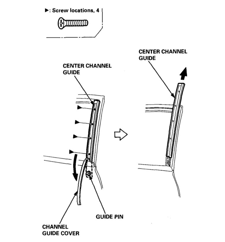

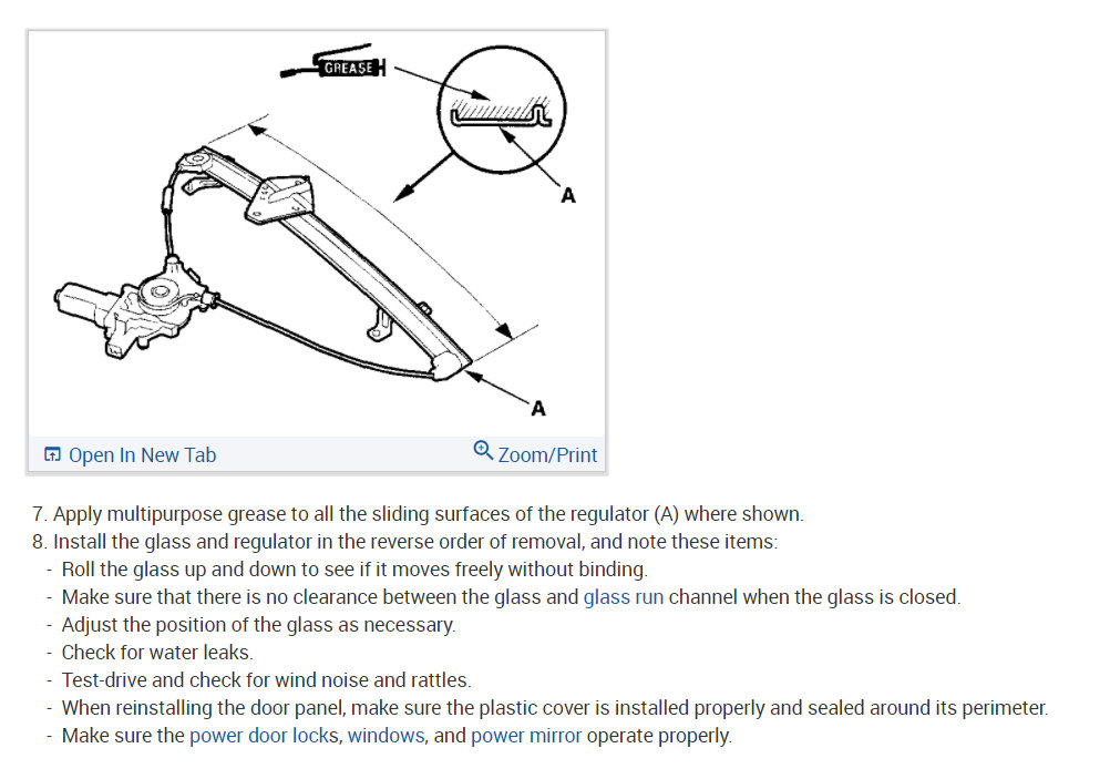

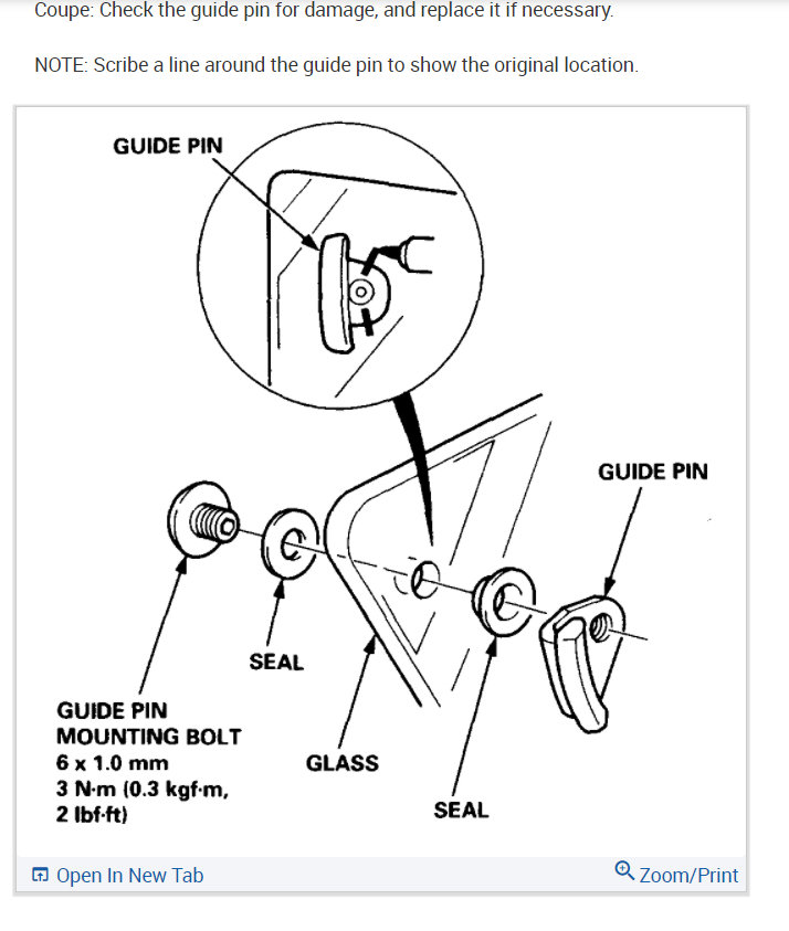

The window of the car, (back left) whenever we open the door or close it the glass slips down. The motor of the window is still working. You can still hear that the motor is running. But the window cannot go up or down. How do I fix it? Can you perhaps post step by step pictures so that we can fix it ourselves? Thank you.
Oct 14, 2020 at 6:35 AM (Merged)
IMPALASS
  • 3,112 POSTS
Hello - Well I have looked in two different manuals and there aren't step by step directions or pics to give you. I am sorry about that. So, what I have done is attach some info from one of the TSBs at least showing you a pic of the area on spring replacement to give you an idea....then I will do my best to kind of walk through what I believe you will be dealing with. The gears may be slipping where the motor connects to the regulator which may be why it will not stay up. Many times on this type, the regulator itself is okay it is just the motor. But you need to look it all over really good. If you are not sure how to do something then please ask........if you can send a pic that is even better. Also, if you have never done this, please be careful.......things are sharp in there and not much space. So move slow and just be careful............. Here is a pic of what you are getting to.
https://images.2carpros.com/forum/automotive_pictures/248015_Accord_Window_Regulator_1.jpg
Remove the door panel......I would purchase some clips that hold the panel on before I remove the panel. Most of the time they break and then your door panel flops around. Just go to the dealer and they can look up how many clips and they should be abut 25 cents each or around there. You may have sound barrier or plastic over the door. Carefully remove that and do your best not to damage it. Once you get to the regulator try to lower the window until you can see the bolts that connect the regulator to the bottom of the window...... Take a couple of rubber door stops and gently jam between the door and the glass to keep the glass from falling down once disconnected. Disconnect the motor connector Remove all the bolts Remove the regulator with motor from the door. Perform a good inspection of the assemble to make sure nothing on the regulator is damaged that may have caused the problem. Remove the old motor - install the new. Then reverse up to the point of putting the door panel on then ops check to make sure it works okay. Then the door panel back on. Please let me know if you have any questions...........I hope this helps..........
