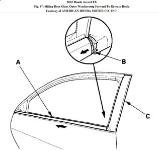

Hi mike232232, Here are the procedures with diagrams. DOOR SASH TRIM REPLACEMENT 2 - DOOR NOTE: Take care not to scratch the door. 1 . Lower the glass fully. 2 . Remove the mirror. 3 . Slide the door glass outer weatherstrip (A) forward to release the hook (B) on bottom of the door sash trim (C) from under the rear end of the weatherstrip.
https://images.2carpros.com/forum/automotive_pictures/192750_DoorSash02AccordFig47_1.jpg

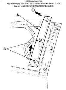

5 . Pull up the door sash trim (A) to release the hooks (B) from the holes in the sash, then remove the trim.
https://images.2carpros.com/forum/automotive_pictures/192750_DoorSash02AccordFig49_1.jpg

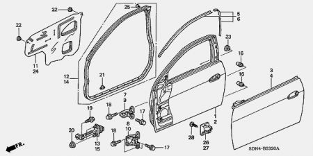

MIKE232232
these instructions are for lower door sash trim, I needed to replace the upper door sash, the spot where door visor would be installed You gave instruction for lower door sash (3,4 in the picture) I needed instructions for door sash (5,6 in the picture) thanks

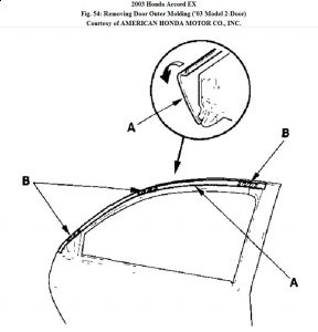

Thise are known as outer mouldings. FRONT DOOR OUTER MOLDING REPLACEMENT Special Tools Required KTC trim tool set SOJATP2014 NOTE: "¢ If you remove the door outer molding, replace it with a new one because it will bend during removal. "¢ Put on gloves to protect your hands. "¢ Take care not to scratch the door. "¢ Use the appropriate tool from the KTC trim tool set to avoid damage when prying components. 1 . Remove these items: "¢ Mirror "¢ Door sash trim, 2 -door "¢ 2 . Remove the door outer molding (A). -While removing the upper edge of the door outer molding from the edge of the sash, cut the double- sided adhesive tapes (B) with a utility knife, then remove the molding.
https://images.2carpros.com/forum/automotive_pictures/192750_DoorMoulding03AccordFig54_1.jpg
3 . Scrape off the remaining double- sided adhesive tape from the sash, then clean the sash surface with a sponge dampened in alcohol. 4 . Install new door outer molding in the reverse order of removal, and note these items: "¢ Push the clip and the adhesive portions into place securely. "¢ Make sure the upper and lower sides of the molding are catching the edges of the sash properly.
