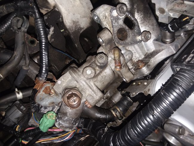

STACY ZIMMERMAN
  • 26 POSTS
Okay, got picture. It bolts to the side of where EGR valve sits.
Jul 1, 2021 at 2:32 AM (Merged)
DANNY L
  • 5,648 POSTS
Hello again.
Okay, just to be on the same page I've attached your picture below.Where I've circled in red are you asking if there is a gasket or o-ring? Let us know and we'll get back to you.Thanks again for using 2CarPros.
Danny-
STACY ZIMMERMAN
  • 26 POSTS
Yes, that's the spot.
DANNY L
  • 5,648 POSTS
Hello again.
It shows the thermostat housing as using an o-ring to seal. I've attached a picture below as to what it looks like.Hope this helps and thanks again for using 2CarPros.
Danny-
STACY ZIMMERMAN
  • 26 POSTS
This one is used for the thermostat seal an not for the seal to the side of EGR valve?
Will check auto parts store an see if they have picture as well. thanks
DANNY L
  • 5,648 POSTS
Hello again.
That is the o-ring that goes from the thermostat housing to the EGR. The o-ring for the actual thermostat is completely round.Let me know if you have any further questions on this issue.Hope this helps and thanks for using 2CarPros.
Danny-
STACY ZIMMERMAN
  • 26 POSTS
What is the gasket if any to go between the EGR an the housing?
DANNY L
  • 5,648 POSTS
Hello again.
Both the thermostat and thermostat housing both use o-ring type gaskets.The thermostat o-ring that bolts to the head-EGR assembly which you are asking about is Honda part number-91312-P0A-000. Hope this helps and thanks again for using 2CarPros.

STACY ZIMMERMAN
  • 26 POSTS
So i have two gaskets as a o-ring one dor thermostat and then one behind to bolt to EGR valve side?
DANNY L
  • 5,648 POSTS
Hello again,
Yes, that it correct. You will have 1 o-ring to use with the actual thermostat and a separate 2nd o-ring to mount the thermostat housing to the EGR valve side.Hope this helps and thanks again for using 2CarPros.
