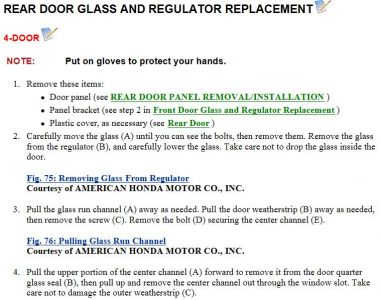

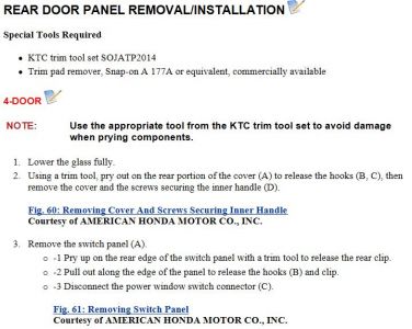

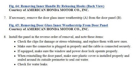

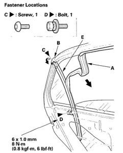

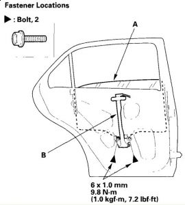

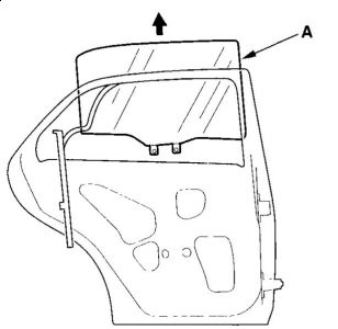

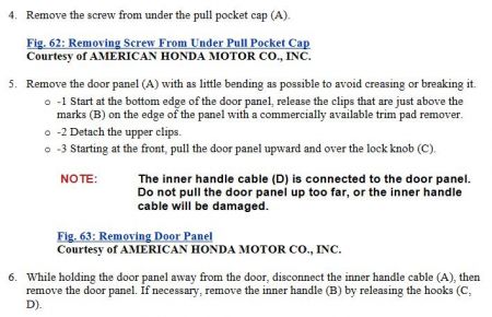

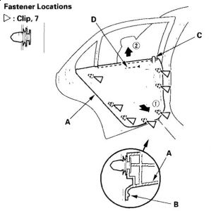

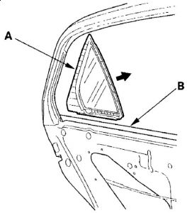

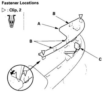

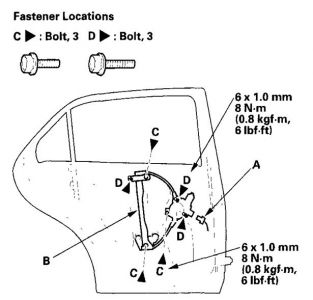

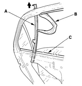

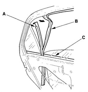

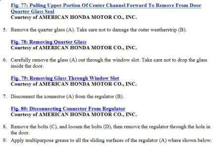

My rear door SASH (black tream behind window) on both rear doors gets rusted. I have ordered the new replacement parts in HONDA dealer, however, would like to replace it my self. I understand that I woul need to remove door panel, then remove window, then replace SASH. Please help with instructions (pictures) .
Thanks
Mar 18, 2009 at 10:46 PM
KHLOW2008
  • 41,814 POSTS

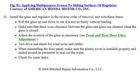

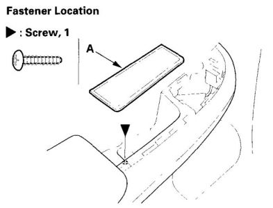

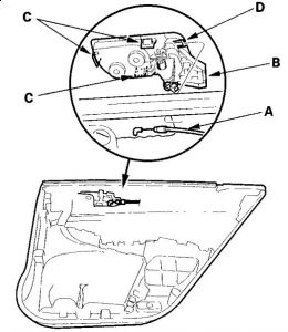

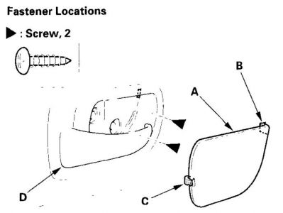

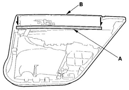

HI olegl, Here are the procedures for removing the door sash and I have a complete procedure for power window motor removal so you can skip those that are not relevant.
https://images.2carpros.com/forum/automotive_pictures/192750_DoorPanelRear03Accord1a_1.jpg
https://images.2carpros.com/forum/automotive_pictures/192750_DoorPanelRear03Accord1a2_1.jpg
https://images.2carpros.com/forum/automotive_pictures/192750_DoorPanelRear03Accord1a3_1.jpg
https://images.2carpros.com/forum/automotive_pictures/192750_DoorPanelRear03Accord1b_1.jpg
https://images.2carpros.com/forum/automotive_pictures/192750_DoorPanelRear03Accord1c_1.jpg
https://images.2carpros.com/forum/automotive_pictures/192750_DoorPanelRear03Accord1d_1.jpg
https://images.2carpros.com/forum/automotive_pictures/192750_DoorPanelRear03Accord1e_1.jpg
https://images.2carpros.com/forum/automotive_pictures/192750_DoorPanelRear03Accord1f_1.jpg
https://images.2carpros.com/forum/automotive_pictures/192750_DoorPanelRear03Accord1g_1.jpg
https://images.2carpros.com/forum/automotive_pictures/192750_DoorGlassRear03Accord01_1.jpg
https://images.2carpros.com/forum/automotive_pictures/192750_DoorGlassRear03Accord02_1.jpg
https://images.2carpros.com/forum/automotive_pictures/192750_DoorGlassRear03Accord03_1.jpg
https://images.2carpros.com/forum/automotive_pictures/192750_DoorGlassRear03Accord0a1_1.jpg
https://images.2carpros.com/forum/automotive_pictures/192750_DoorGlassRear03Accord0a2_1.jpg
https://images.2carpros.com/forum/automotive_pictures/192750_DoorGlassRear03Accord0a3_1.jpg
https://images.2carpros.com/forum/automotive_pictures/192750_DoorGlassRear03Accord0a4_1.jpg
https://images.2carpros.com/forum/automotive_pictures/192750_DoorGlassRear03Accord0a5_1.jpg
https://images.2carpros.com/forum/automotive_pictures/192750_DoorGlassRear03Accord0a6_1.jpg
https://images.2carpros.com/forum/automotive_pictures/192750_DoorGlassRear03Accord0a7_1.jpg
