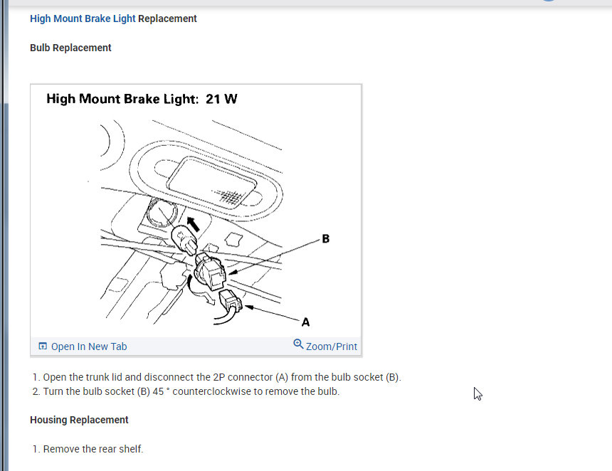

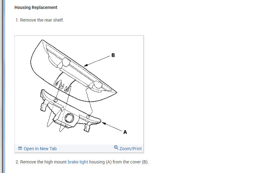

How to replace brake light bulb?
Mar 27, 2009 at 11:16 PM
Here are some guides that will help with this:
https://www.youtube.com/watch?v=xP3Q7dREbFQ
https://www.2carpros.com/articles/brake-lights-not-working
Below is the process from the manual that will give more info. Please let us know if you need more info. Thanks
