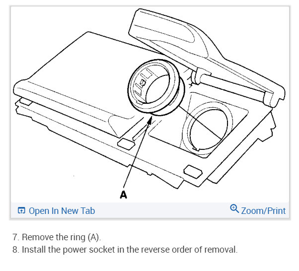

The car lighter/12v power outlet is not working. How do I replace it? Where can I get a replacement? Could you please let me know the procedure.

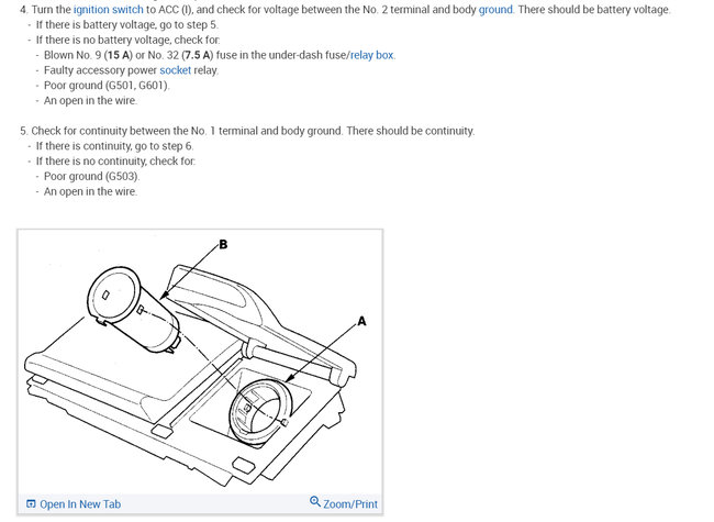

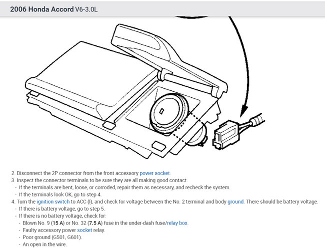

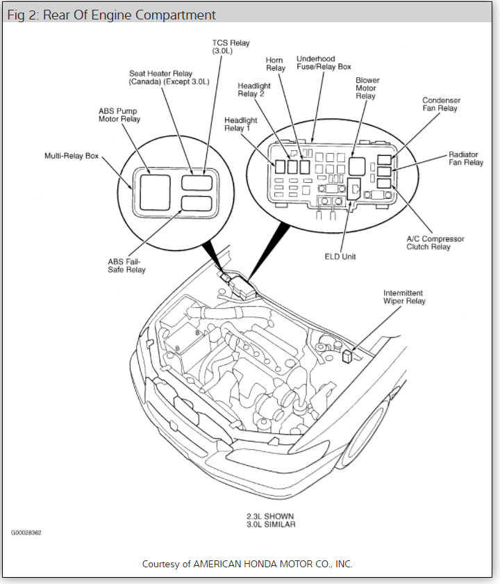

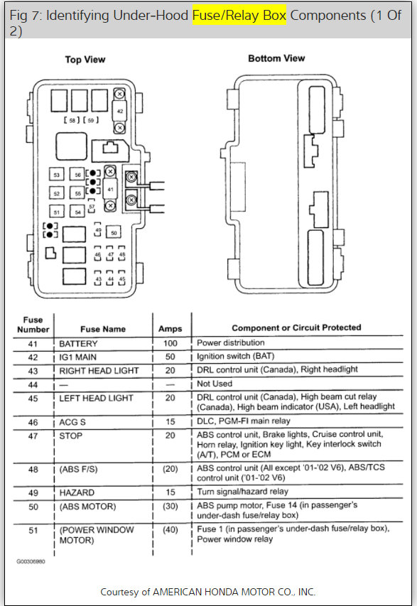

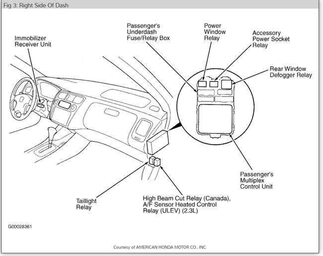

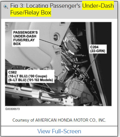

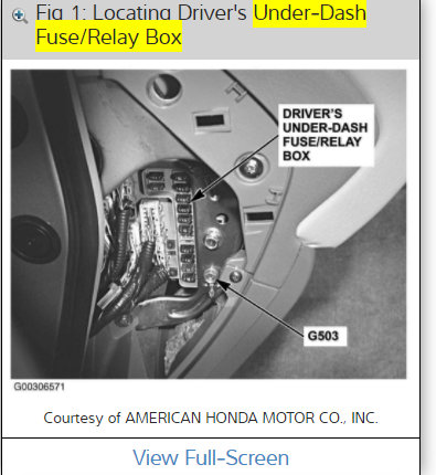

Here are diagrams to help you change the power outlet. You should also check fuse No. 9 (15 A) or No. 32 (7.5 A) fuse in the under-dash fuse/relay box. Here is a guide to help with diagrams below.

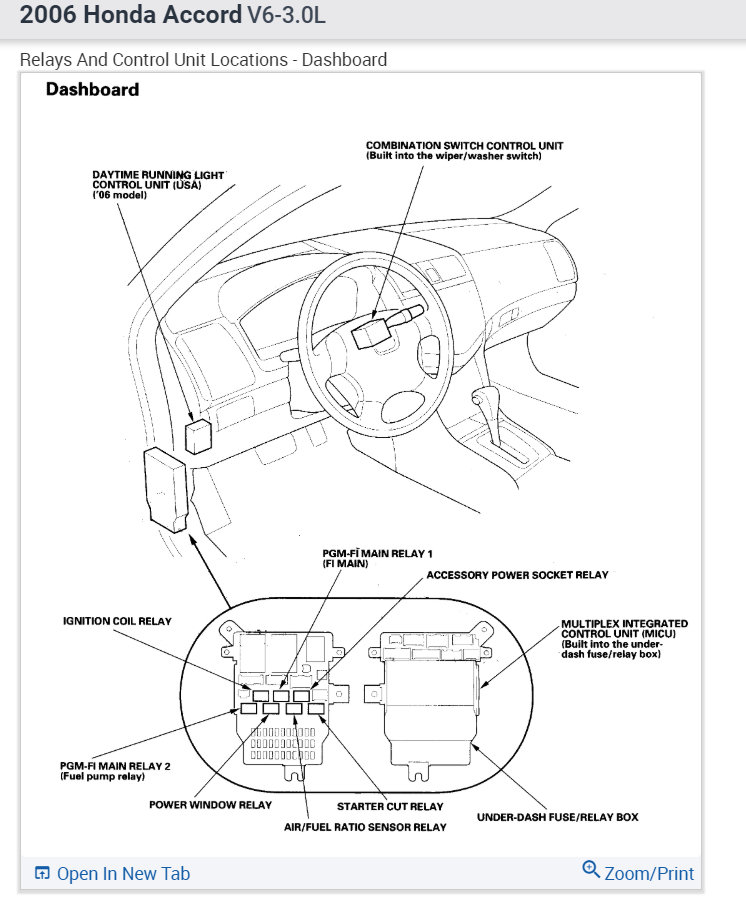

Can you tell me where I can find the fuse for the power outlet just under the radio
By the shift lever.
Wednesday, January 9th, 2019 AT 11:25 AM (Merged)
HONDA TECH 1818
  • 536 POSTS

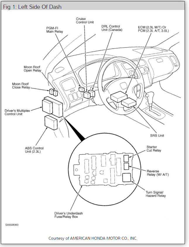

The fuse is located in driver's side fuse box at the kick panel, it is fuse #9 15amp fuse

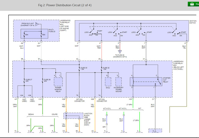

There is one fuse you need to check #32 7.5 amp int he fuse panel here is a guide to help you see how to check the fuse.
Here is the power outlet wiring so you can see how it is powered and the fuse box diagrams.

You need to check for power supply to the power outlet. If power is available, the socket is faulty.
You need to remove the socket wire harness to check.

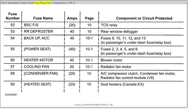

Check the following fuses
1. No 9 (20A) fuse at passenger side fusebox.
2. No 8 (7.5A) at driver side fuse box.
3. No 54 (40A) under bonnet.
+2
