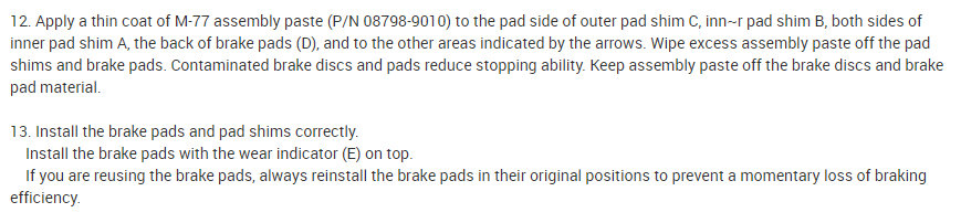

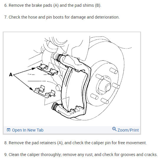

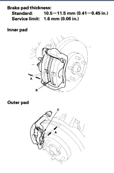

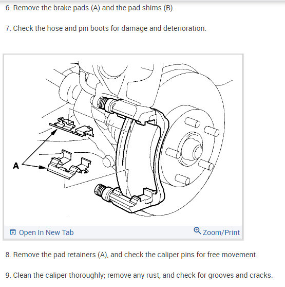

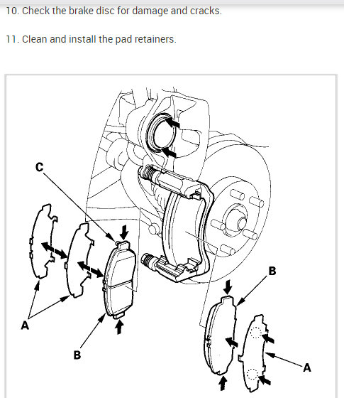

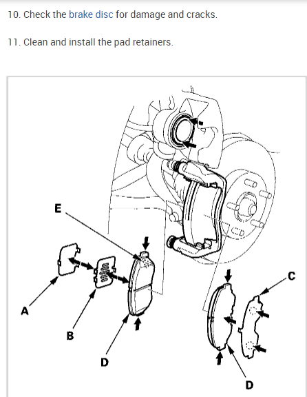

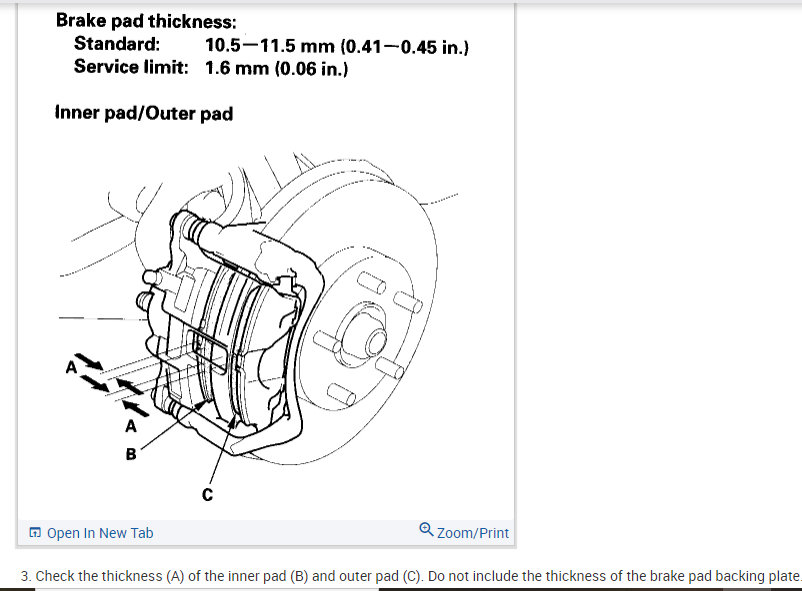

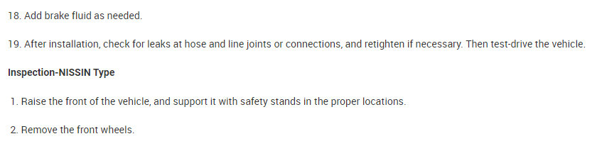

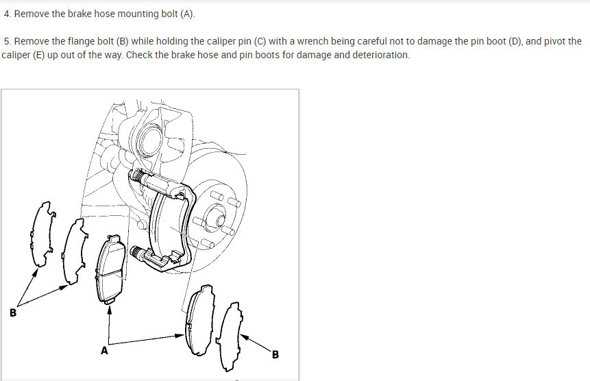

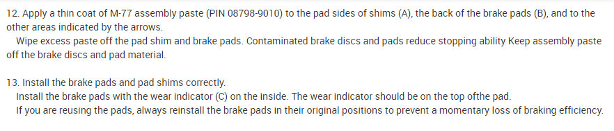

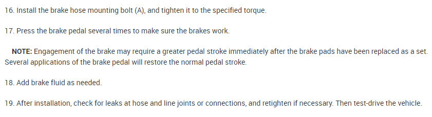

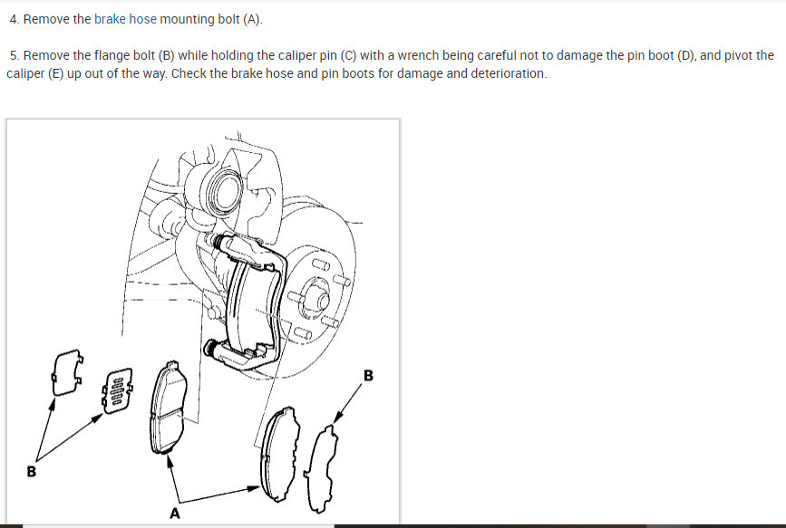

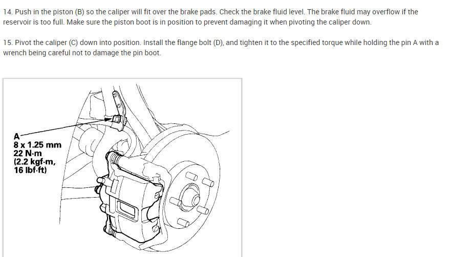

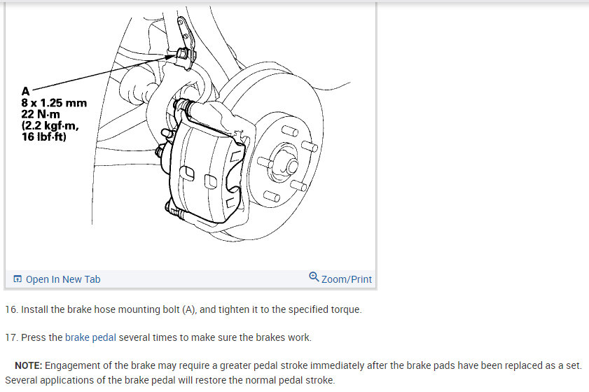

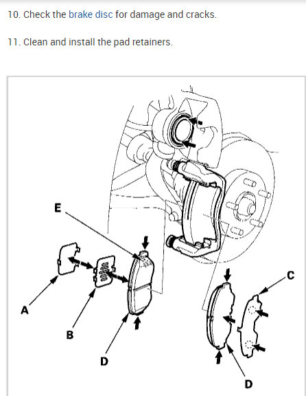

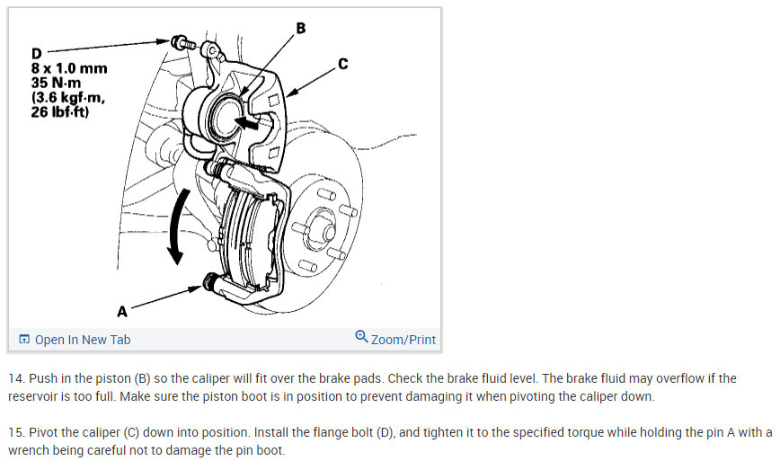

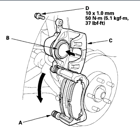

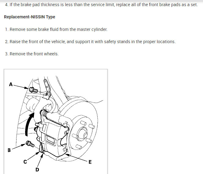

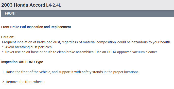

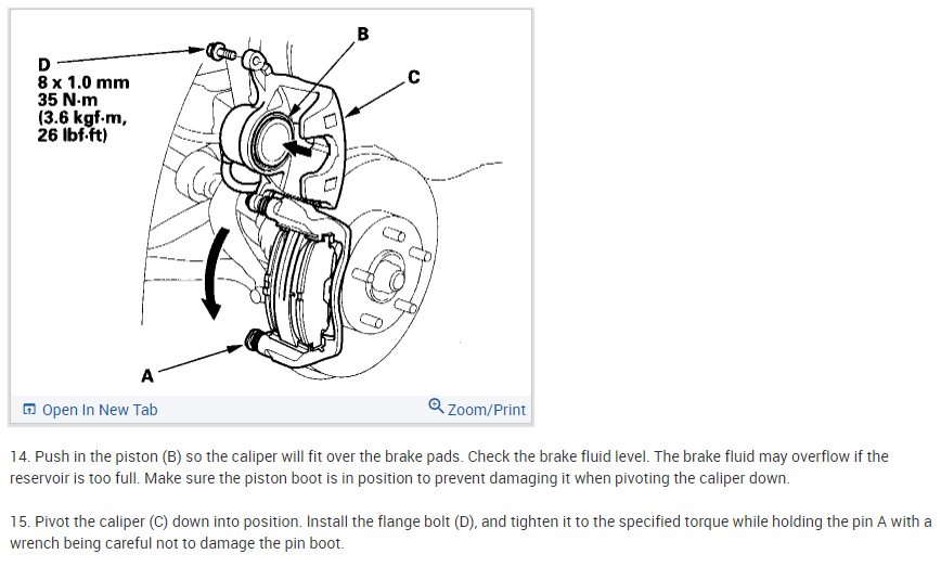

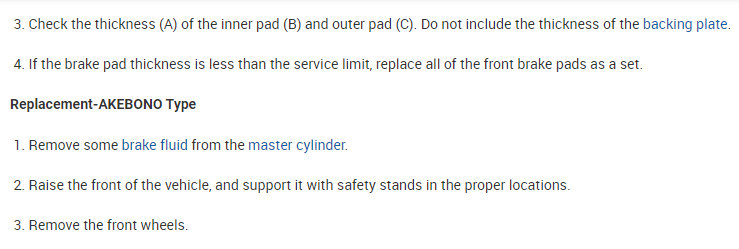

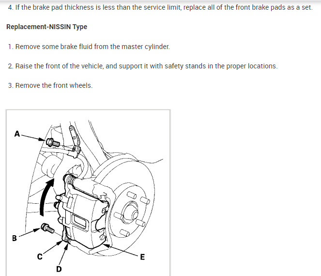

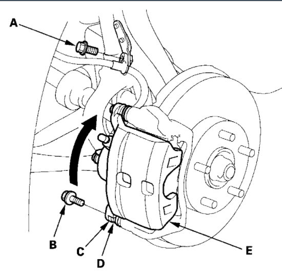

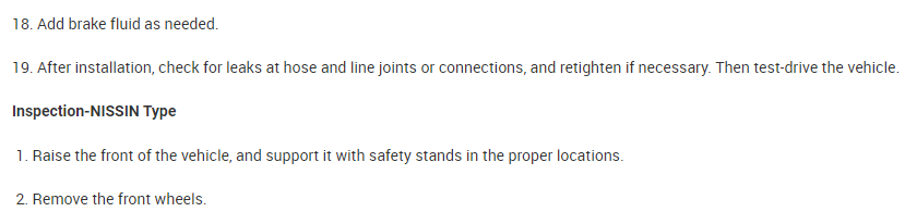

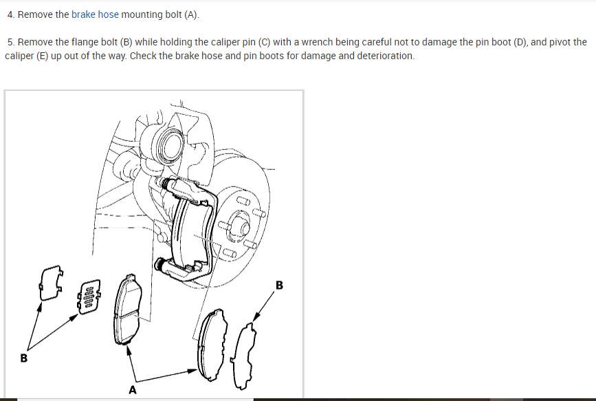

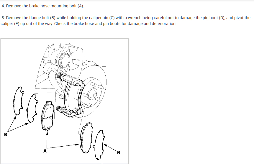

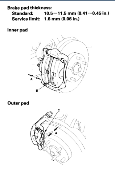

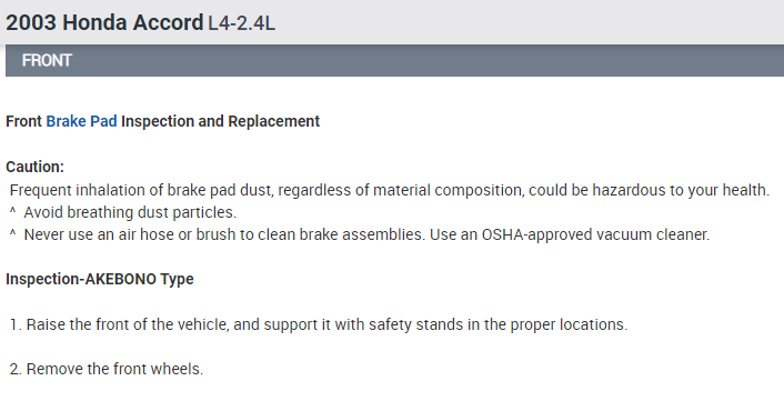

I need instructions on how to change the front brake pads?
Thursday, April 2nd, 2009 AT 10:17 PM
DANNY L
MECHANIC
5,648 POSTS
Hello, I'm Danny.
Here is the information you requested. This is a tutorial for you to view on how to change front brake pads:
I've attached picture steps below on how to change the front brake pads on your car. Hope this helps and thanks for using 2CarPros.
