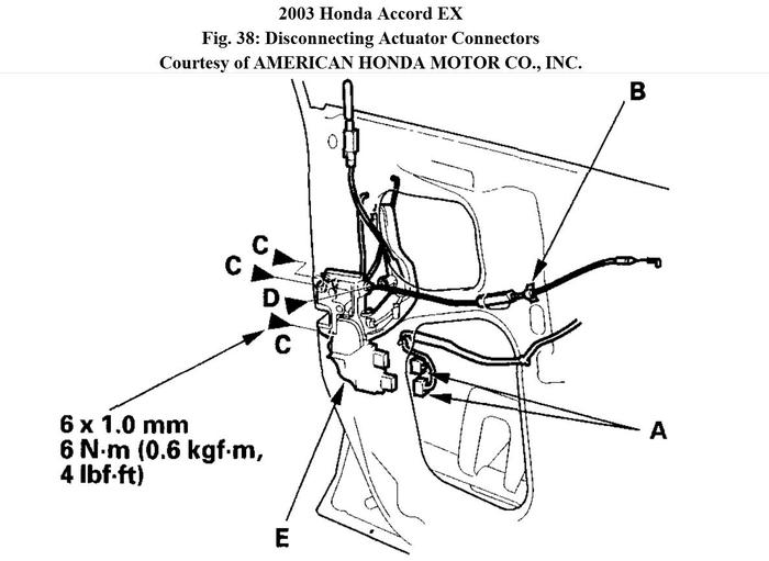

My 4-doors all work well except when I want to get out of the driver's seat. The inside door lever is not connected to the latch. The cable pulled out of its end. I have a new cable and have removed the door panel. How can I get at the latch inside the back of the door to complete the replacement of the old cable with my new one?

My question was on the removal of the latch down inside the back edge of the door so that I could install the cable from the lever so that I could open the door from inside the car. The non-answer offered was a detailed account of the panel removal. What I need would be between steps 8 and 9. If you don't know how to get at the latch just admit it.

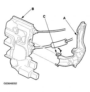

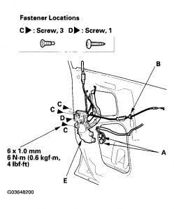

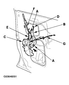

Here is the info you need to get the job done :) 1.Raise the glass fully. 2.Remove these items: ? Door panel (see FRONT DOOR PANEL REMOVAL/INSTALLATION ) ? Plastic cover, as necessary (see Front Door ) ? Center lower channel (see 3 ) 3.Disconnect the cylinder rod from the lock cylinder, and disconnect the outer handle rod from the outer handle (see 4 ). 4.Remove the screw securing the lock knob (A). 5.Disconnect the actuator connectors (A) (for some models), and detach the inner handle cable clip (B). Remove the screws (C, D) securing the latch (E) and the lock cable protector. 6.Release the hooks (A) of the lock cable protector (B) from the door, then remove the latch (C) with the protector through the hole in the door. Take care not to bend the outer handle rod (D), cylinder rod (E), lock cable (F), and inner handle cable (G). 7.Remove the lock cable protector (A) from the latch protector (B) by releasing the hook (C). 8.Install the latch in the reverse order of removal, and note these items: ? If equipped, make sure the actuator connectors are plugged in properly and each rod is connected securely. ? Make sure the door locks and opens properly.
