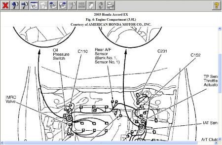

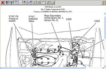

My car has 47K on it and the check engine light came on on the code reader it gives 2 codes first p2251 and then p0138 I would like to know the location of these o2 sensors.
Jan 4, 2009 at 7:41 AM
KHLOW2008
  • 41,814 POSTS
Hi nabeel, DTC P2251: REAR A/F SENSOR (BANK 1, SENSOR 1) VS LINE HIGH VOLTAGE DTC P0138: REAR SECONDARY HO2S (BANK 1, SENSOR 2) CIRCUIT HIGH VOLTAGE (2005-2007 MODELS)
