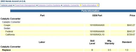

Sorry don't know how to spell it. I had it diagnosed and they said the catalyc converter was going out. The car hesitates at certain speed just a bit but it still runs fine. How much should I expect to get this fixed?

https://www.2carpros.com/forum/automotive_pictures/12900_c_6.jpg
Note:Part and labor varies within location.
