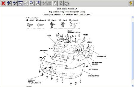

how do i remove the front bumper and the splash shiles under the car . my dughter smash the bumper and the plastic under the car and the wheel well i have to remove it and reinstall it all

Hi 1tom, 4-DOOR NOTE: Have an assistant help you when removing and installing the front bumper. Take care not to scratch the front bumper and body. Put on gloves to protect your hands. 1. Remove the front bumper as shown below. 2. Install the bumper in the reverse order of removal, and note these items: a) Make sure the front bumper engages the hooks of the side spacers and upper beams on both sides securely. b) Check if the clip is damaged or stress-whitened, and if necessary, replace it with new one.
https://images.2carpros.com/forum/automotive_pictures/192750_BumperFr03Accord4dr_1.jpg
