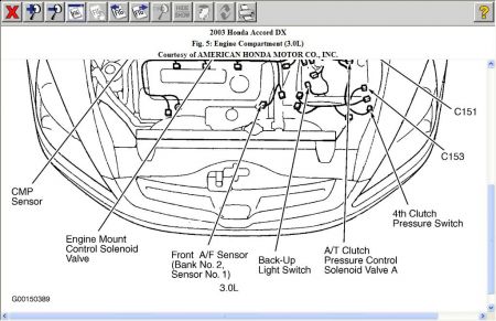

back up lights won't go on. Fuse and bulbs good. Where is the gear position sensor/switch?

Its on top left of transaxle see below
https://images.2carpros.com/forum/automotive_pictures/12900_backup_switch_1.jpg
