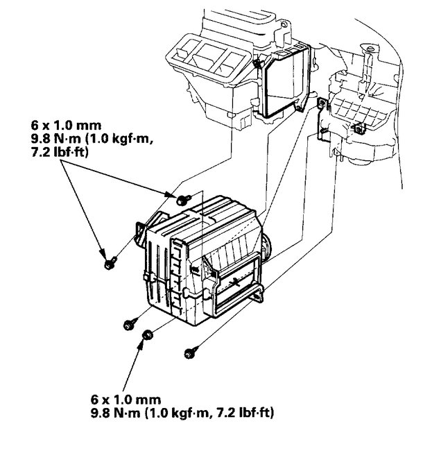

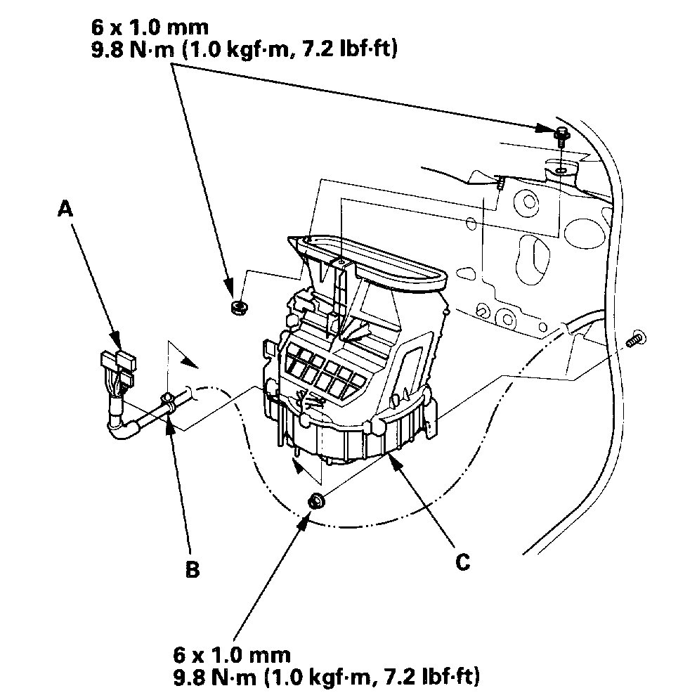

Are you sure the fan motor is not bad? I would remove it and supply power directly to it to confirm it works properly. If it does, then it is hitting something in the box.
Here are the directions specific to your vehicle for removal and replacement. Check through them to confirm something was not put together wrong. The attached pictures correlate with these directions
______________________________
Blower Unit Removal and Installation
SRS components are located in this area. Review the SRS components locations, precautions, and procedures in the SRS section before performing repairs or service.
1. Make sure you have the anti-theft code for the radio, then write down the frequencies for the radio's preset buttons.
2. Disconnect the negative cable from the battery.
3. Remove the dashboard.
4. With air conditioning; remove the evaporator.
5. Without air conditioning; remove the self-tapping screws, the mounting nut, the mounting bolts and the heater duct.
6. Disconnect the connectors (A) from the blower motor, the blower resistor and the recirculation control motor, then remove the wire harness clip (B). Remove the mounting nuts, the mounting bolt and the blower unit (C).
7. Install the unit in the reverse order of removal, and note these items:
- Make sure that there is no air leakage.
- Enter the anti-theft code for radio, then enter the customer's radio station presets.
_______________________________________
Let me know if this helps or if you have other questions. Note: When you test it outside of the vehicle, make sure the fan itself is tight and the bearing in the motor is not allowing things to wobble.

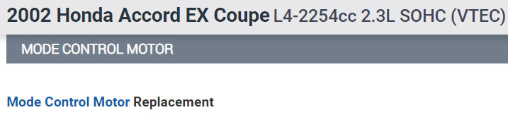

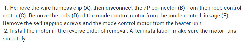

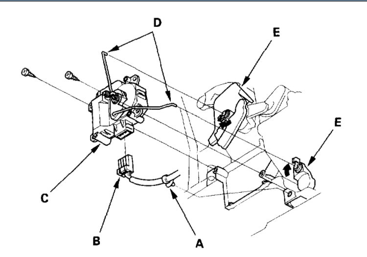

DANNY L
  • 5,648 POSTS
Hello, I'm Danny.
Here is a tutorial showing how the replace a mode-blend door actuator. It's a small electric motor that opens and closes a door to circulate air flow through certain air ducts in the HVAC box. I've attached picture steps below on how to replace the mode actuator on your car. Hope this helps and thanks for using 2CarPros.
