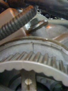

What the timing marks?
Tuesday, August 24th, 2010 AT 6:58 PM
3 Replies
HONDA TECH 1818
MECHANIC
536 POSTS
#1 is line up with the mark on the top mark.
The rear top dead center line is line up with the top mark.
The bottom crank dot is line up with mark on the bottom.

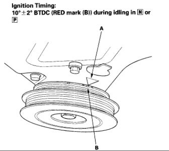

Timing Marks and Indicators
hn02accv6_sm_4-018b

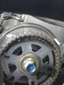

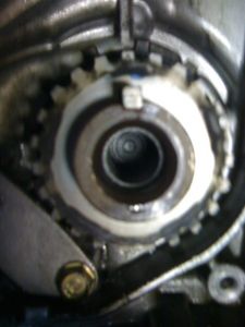

Here's some better pictures of it.
