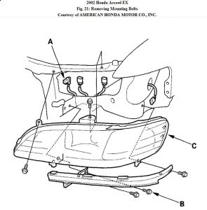

How do I replace the bulb on the driver side headlight
DJMAN56
MEMBER
2002 HONDA ACCORD
Thursday, January 7th, 2010 AT 7:06 AM
KHLOW2008
MECHANIC
41,814 POSTS
Hi DJMAN56,
Unplug the connector A and pull out the rubber cover.
Unclasp the spring clip holding the bulb and it can be removed. DO NOT touch the bulb glass part with your fingers.
