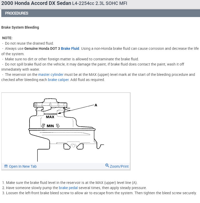

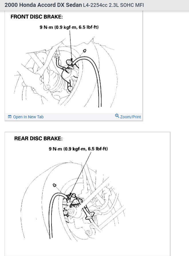

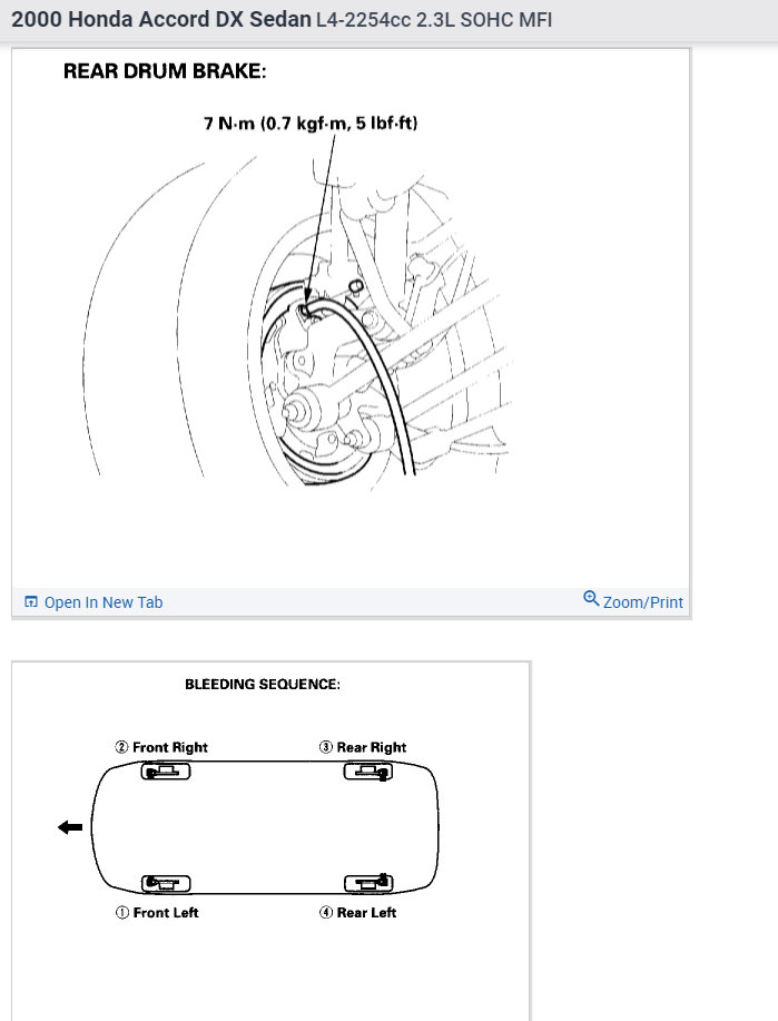

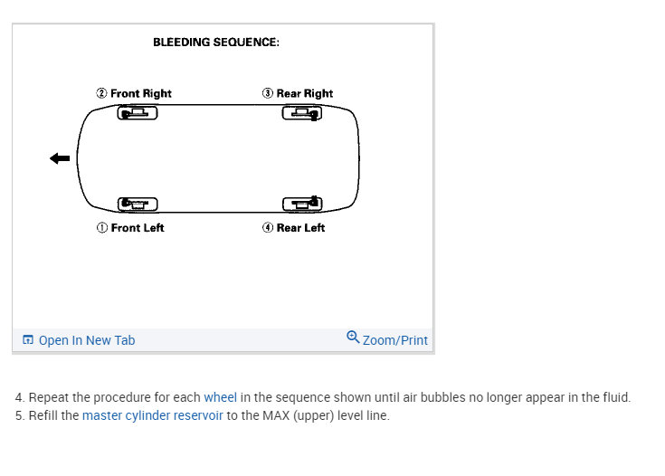

how do i bleed the brakes, and what type fluid
Sep 12, 2009 at 9:28 PM
SQM
Experienced Mechanic
6,383 POSTS
This vehicle uses DOT 3 brake fluid.
Here is a helpful guide on how to bleed the brakes:
https://www.2carpros.com/articles/how-to-bleed-or-flush-a-car-brake-system
