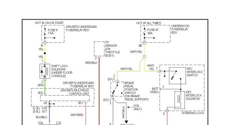

Perhap I should have given you more information.
1. I have no blown fuses.
2. I hear the clicking noise when the ignition is switch on in the console.
3. I have no brake lights.
4. I tried jumping the connector in all possible ways in order to complete a circuit. No help.
5 It acts like there is no power to the switch. I can also hear the relay above the switch kick on an off.
6. I put a multimeter on the new switch checking for continuity from any combination of two points. I get no continuity regardless of whether the buttons is out or depressed.
7. I am trying to avoid spending money here since I have been out of work for 8 months. That is why I came here instead of taking it to a shop.
Oct 25, 2008 at 8:58 AM
  • 75,992 POSTS

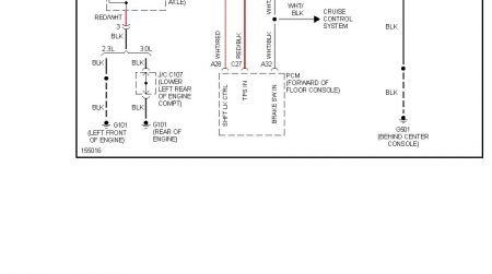

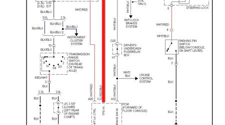

6. I put a multimeter on the new switch checking for continuity from any combination of two points. I get no continuity regardless of whether the buttons is out or depressed. When the button is out-you should have continuity and when depressed no continuity. Check fuse no.47 20amp and fuse no.9 7.5amp Have you checked the key interlock solenoid?-see shift interlock system circuit below
https://images.2carpros.com/forum/automotive_pictures/12900_shift_interlock1_1.jpg
https://images.2carpros.com/forum/automotive_pictures/12900_shit_interlock2_1.jpg
https://images.2carpros.com/forum/automotive_pictures/12900_shift_interlock_system3_1.jpg
