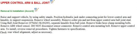

hello,
Can you please tell me how to replace passenger rear upper control arm. I have to replace it with a adjustable arm for my alignment.

https://images.2carpros.com/forum/automotive_pictures/261618_Noname_2657.jpg
