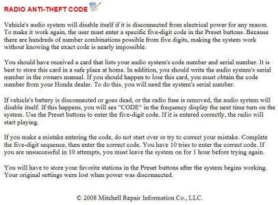

need to know how to reset radio
Mar 29, 2009 at 4:10 PM
KHLOW2008
  • 41,812 POSTS
Hi sandi rose, Here you are.
https://images.2carpros.com/forum/automotive_pictures/192750_RadioCodeHonda_1.jpg
