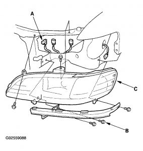

How do you replace the headlight assemblies?

HEADLIGHT REPLACEMENT
1. Remove the front bumper
2. Disconnect the connectors (A).
3. Remove the 5 mounting bolts (B), then remove the headlight assembly (C).
Fig. 21: Removing Mounting Bolts & Headlight Assembly
https://www.2carpros.com/forum/automotive_pictures/55316_02accordheadlight_1.jpg
HEADLIGHT: 60/51 W
FRONT PARKING LIGHT: 5 W
4. Install the headlight in the reverse order of removal.
5. After replacement, adjust the headlights to local requirements.
